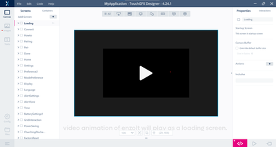

‎2024-12-19 6:25 AM - edited ‎2024-12-19 7:25 AM
I have successfully migrant simulator project to STM32H7S78-DK board,
but after migration load and simulator option is disabled.
Here i attached screenshot,
/Mehul
