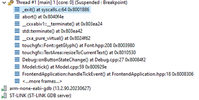

‎2024-12-02 5:39 AM
Thanks for the quick reply. I don't know how to get the stack call since the program didn't crash but actually navigated to an infinite loop. I am not familiar with CubeIDE.
I tried to call the goto____NoTransition function from a presenter and it went to the infinite loop again.
The thing I forgot to say is, actually the screen transition happens. I can see the new screen on my display then nothing responds. When I pause the program using IDE, I can see that it is in syscall.c -> _exit function.
I placed a breakpoint to my line:
static_cast<FrontendApplication*>(Application::getInstance())->gotoScreen2ScreenNoTransition();
Then I moved step by step and when I got to the _exit function, the list on the left side (I hope this is the stack trace) was like this:
‎2024-12-02 5:40 AM
Now I realize that something is wrong about the resizeToCurrentText. I'll investigate.

What is on line 59 of the Model.cpp?
Keep me updated when you have finished investigating!

‎2024-12-02 11:18 PM - edited ‎2024-12-02 11:24 PM
Somehow the problem was me calling resizeToCurrentText() function of TextArea.
Let me show you my whole Model.cpp
The line 59 is the line 52 here. Where I call something from debugWidgetPointer.

Looks like if I forget to implement the call for this bind function, the debugWidgetPointer is not null but simply points to a weird place (I guess?) and cause unexpected results. I think the only thing I need is a way to nullify these pointers when a screen change happens. Do we have a single place that is called everytime screen changes? Preferably somewere that can access modellistener or model?
EDIT: I tried to nullify them in modellistener's constructor but the code still exits if I don't bind the pointer.
‎2024-12-02 11:50 PM
Hello @starcin ,
It is great new that you were able to track down the root cause of the issue.
We have a function that is called every time we exit a screen, this is the tearDownScreen() function (setupScreen() is called whenever we instantiate a screen).

‎2024-12-11 10:51 PM
I couldn't find a way to automate nullifying the pointers, or maybe I have another problem in that area, so I am just being careful about adding and removing stuff in my classes. But since it was actually a pointer issue and not a scene change issue, I guess we can say that I moved forward.
‎2024-12-12 4:51 AM
Hello @starcin ,
Would this fix your issue if you put it in every setupScreen() function :
debugWidgetPointer = nullptr;
