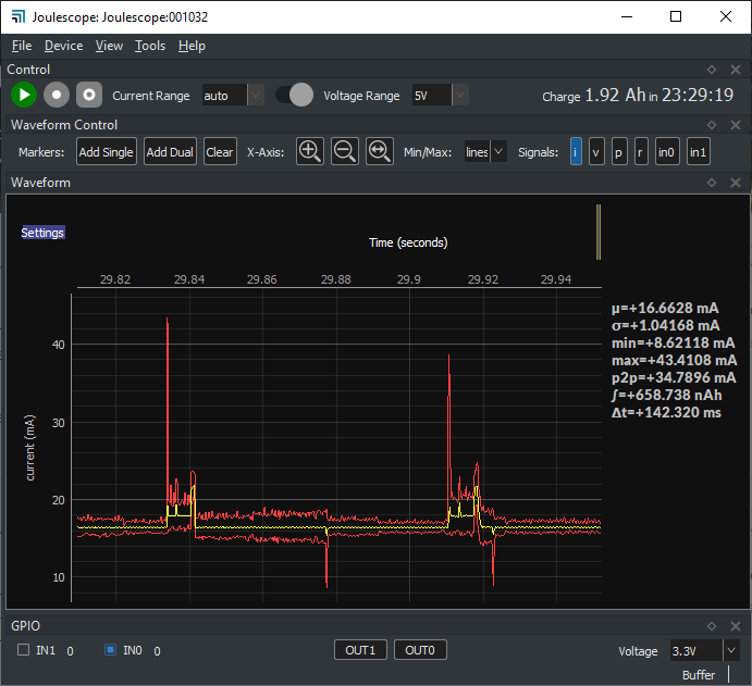

This may not be the best place to put this, because it has more to do with power optimization, not operation in low power modes, but since it's touchscreen-related, here it is anyway.
The FT6x06 touchscreen controller used on the 469i-DISCO board (and probably the 7 series as well?) has a couple of settings that can reduce power. By default, the chip operates in a MONITOR mode, where it periodically scans for a touch at an interval set by the PERIODMONITOR register. Then, upon detecting a touch, it immediately switches to ACTIVE mode, where it reports touch data at a higher rate. After a period of time has elapsed with no touch, set by the TIMEENTERMONITOR register, it returns to MONITOR mode, which reduces the power consumption. The factory default setting for PERIODMONITOR is 0x28, which is 40ms. You can save some power by increasing this register value. I did not perceive a difference from a user perspective when setting it to 0x50, or 80ms. The bigger power saver, especially if your application is touchscreen intensive, is the TIMEENTERMONITOR setting, which is 0x0A by default, or 10 seconds. Why you would need to wait ten seconds to enter MONITOR mode is beyond me. I changed this value to 1 second. By my measurements, the TS controller draws a little over 1mA extra when in ACTIVE mode. Optimizing these values can make a difference, albeit small, in your power consumption. I added a couple of calls to the Reset function of the driver, since it is called when the touchscreen is initialized (see below).
Also, if you are in a low power mode, e.g. STOP mode waiting for a touch, an even further-reduced scan rate could be set, and then bumped up to a normal value on wakeup. Since the touchscreen is always operating even in STOP mode if you want to wake on touch, this could make a more significant difference in power consumption than during normal operation.
void ft6x06_Reset(uint16_t DeviceAddr)
  /* Do nothing */
  /* No software reset sequence available in FT6206 IC */
  /* Code below added to reduce operating current.
   * Scan interval is in ms and default is 0x28 (40ms). Change to 0x50 (80ms).
   * Time to wait before switching to MONITOR mode after a touch is in
   * seconds (roughly). Default is 0x0A (10s), change to 0x01 (1s).
  TS_IO_Write(DeviceAddr, FT6206_TIMEENTERMONITOR_REG, 0x01);
  TS_IO_Write(DeviceAddr, FT6206_PERIODMONITOR_REG, 0x50);
 Note: A very quick tap of the screen might be missed at an 80ms interval.
For reference, here is a plot with two scans of the touch controller during MONITOR mode while the STM32 is in Stop mode.
