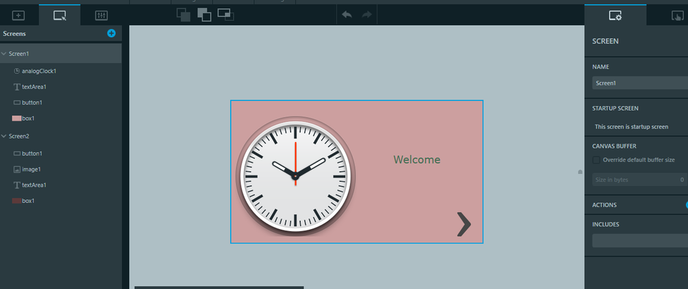

i wanted to create a project with touchGFX but there are errors, i just create the graphic interface, i didn't add any code!

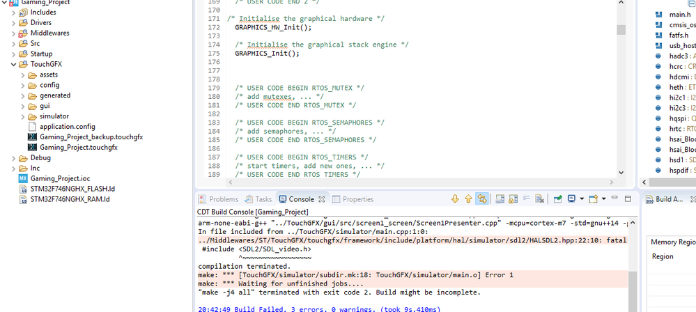

Please show me the log from the designer on why "run target" fails - Which board is this? You need ST-Link installed, and you haven't, is my guess.

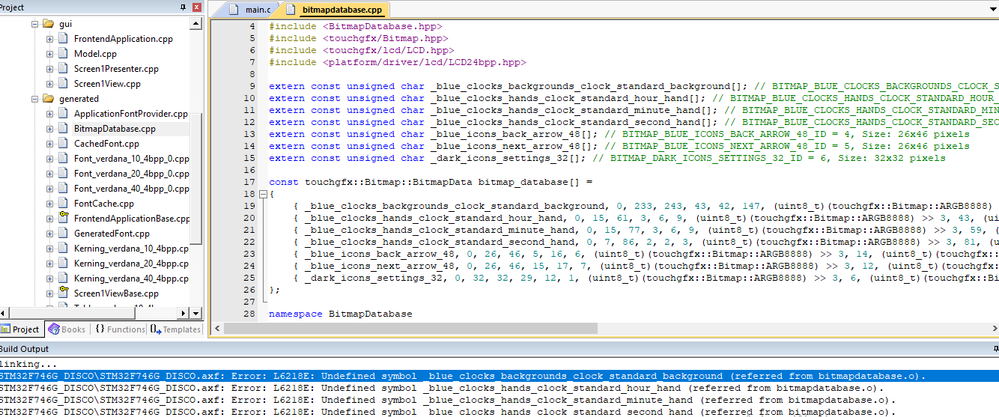

As far as your linker issues - Looks like the generated image code has not been added to your project. This looks like Keil - Did you simply start from an Application template? The "Generate" code button should update the project with new files but you can add them manually - I'm not sure what could be wrong with that - but "Generate code" will fail if it cannot execute its "post generate command".

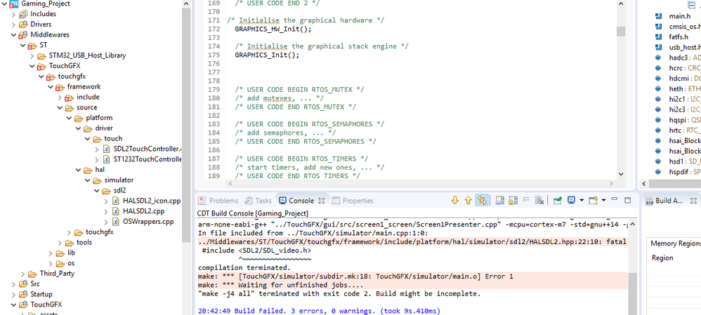

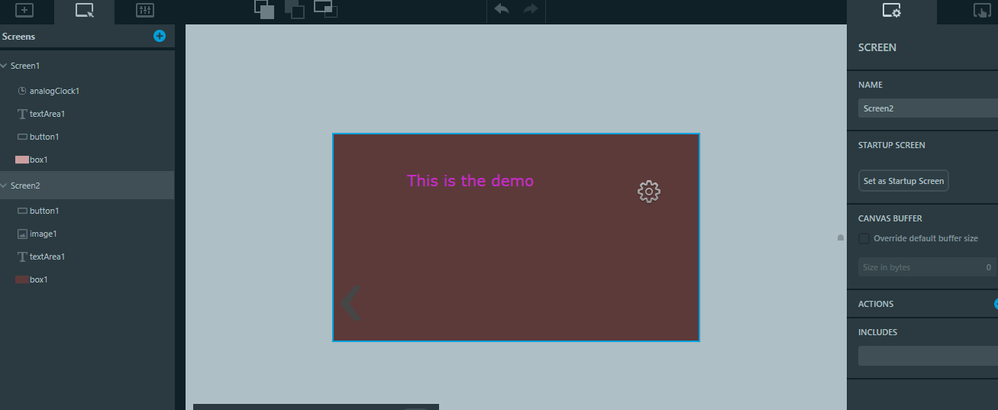

so, I created a project on cubeIDE, I added TouchGFX on the middleware, then I executed TouchGFX Designer, I created 2 screen to test, Then I opened again Cube IDE, and here the errors.
I use Cube IDE 1.0.2 and touchGFX 4.13.0
N.B.: I tried to exclude simulators files as someone did on a tutorial but it didn’t work!

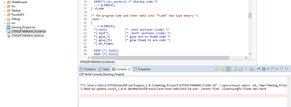

I got 1 error now, please help, I can't understand how to make .elf
It said cannot find -llibtouchgfx-float-abi-hard
There's a linker error somewhere - Can you show me a bit further up the log window?

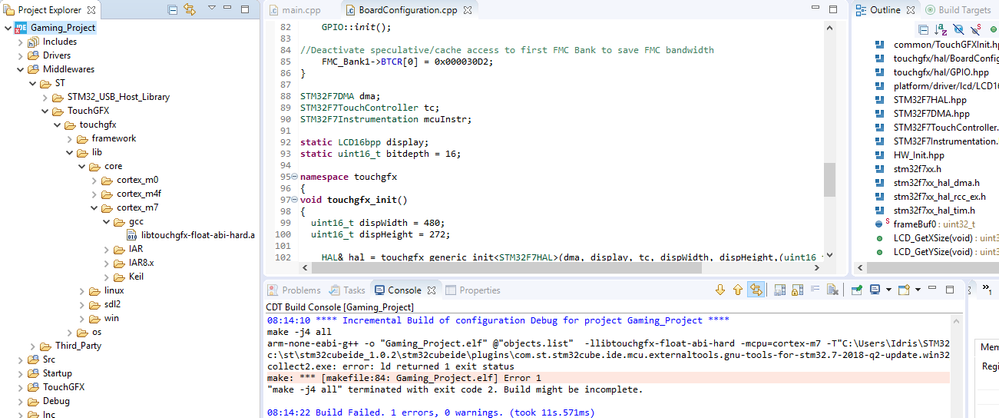

14:39:21 **** Build of configuration Debug for project Gaming_Project ****
make -j4 all
arm-none-eabi-g++ -o "Gaming_Project.elf" @"objects.list" -llibtouchgfx-float-abi-hard -mcpu=cortex-m7 -T"C:\Users\Idris\STM32CubeIDE\workspace_1.0.2\Gaming_Project\STM32F746NGHX_FLASH.ld" --specs=nosys.specs -Wl,-Map="Gaming_Project.map" -Wl,--gc-sections -static -L"C:\Users\Idris\STM32CubeIDE\workspace_1.0.2\Gaming_Project\Middlewares\ST\TouchGFX\touchgfx\lib\core\cortex_m7\gcc" --specs=nano.specs -mfpu=fpv5-sp-d16 -mfloat-abi=hard -mthumb -Wl,--start-group -lc -lm -lstdc++ -lsupc++ -Wl,--end-group
c:\st\stm32cubeide_1.0.2\stm32cubeide\plugins\com.st.stm32cube.ide.mcu.externaltools.gnu-tools-for-stm32.7-2018-q2-update.win32_1.0.0.201904181610\tools\arm-none-eabi\bin\ld.exe: cannot find -llibtouchgfx-float-abi-hard
collect2.exe: error: ld returned 1 exit status
make: *** [makefile:83: Gaming_Project.elf] Error 1
"make -j4 all" terminated with exit code 2. Build might be incomplete.
14:39:40 Build Failed. 1 errors, 0 warnings. (took 18s.447ms)

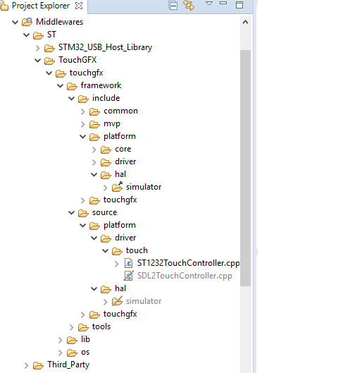

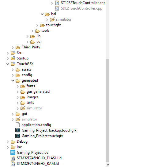

here what i excluded:

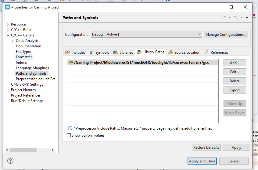

here the path I added:

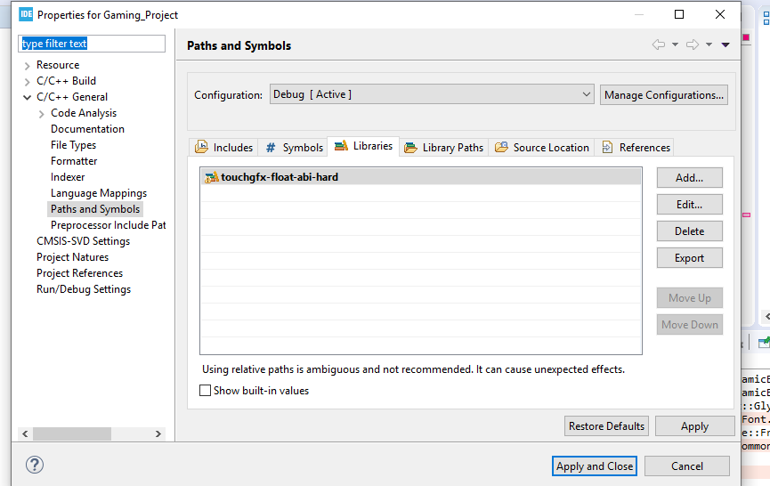

Is the library on your library path ("Library Paths")? Also, the syntax looks strange, but this may just be representation from CubeIDE since the library seems to be correctly listed in your screenshot.
