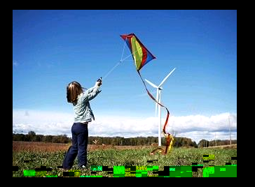

JPEG encoding issue when using DMA on STM32H7B3
ALamb.314
with libjpeg or using hardware in polling, mode compression works fine.
but when using DMA image is getting corrupted

Check that the memory you use for the DMA buffers is accessible to the JPG block. I had 6 months of grief finding this out on an F7 as by default only the first 128k is in the correct cache region

Thanks
got it working
I had to put
 SCB_CleanInvalidateDCache();
 SCB_InvalidateICache();
before dma call and removing this line "HAL_JPEG_ConfigInputBuffer(hjpeg, YCBCR_IMG, 4);" from HAL_JPEG_GetDataCallback
