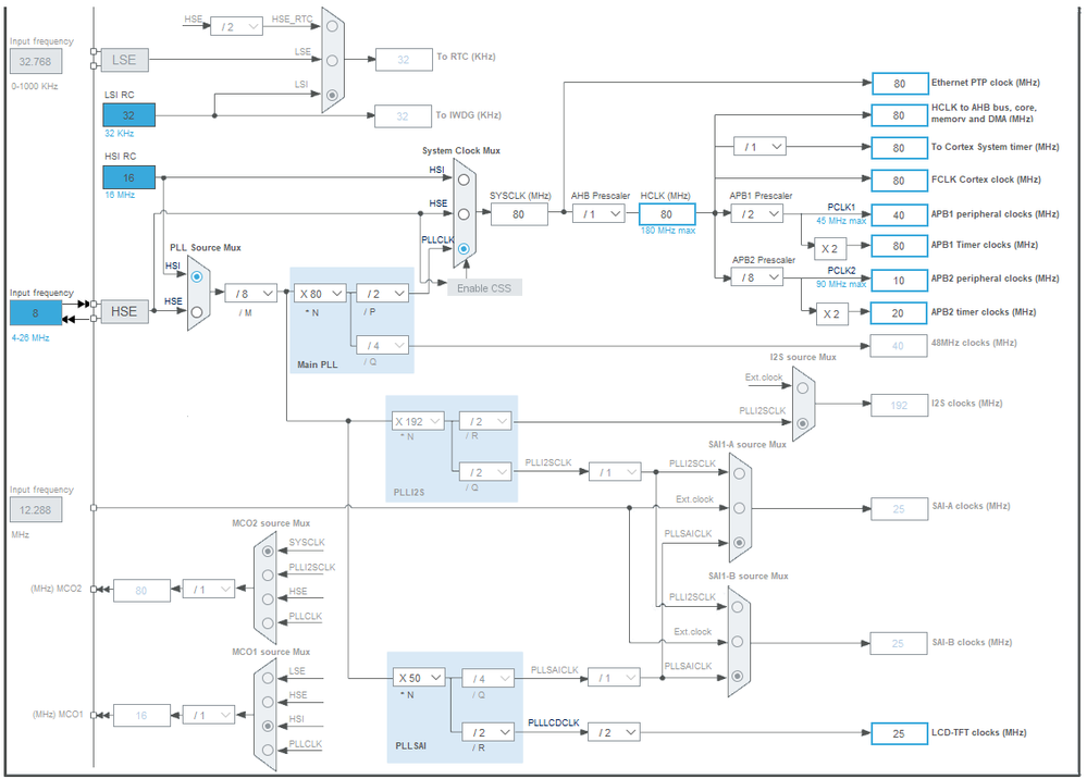

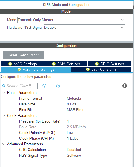

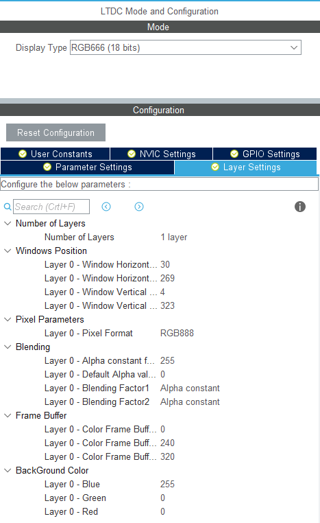

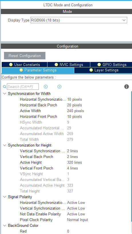

I got a STM32F429I DISCO. I’m trying to configure LTDC to display a black screen (it should be simple:grinning_face_with_sweat: ), but i don’t really succed it.
I am really confused because i don’ t understand the following things :
1. Does the STM32F429I DISCO implement Serial (SPI) or parallel interface ? Because according to the datasheet, the 4 – Wire Serial is configured (IM[3:0]=0110), so how can we use ther the LTDC ?
2. Is the ILI9341 library mandatory to use the display ?
You can see my configuration above.
Thanks !
Both SPI, and the "native", "controllerless" RGB parallel interface.
(The "controlled" parallel interface, sometimes called 8080/68k, is sort of usable, but would be impractical to use given the LTDC and FSMI pins don't match, nor are the LTDC data pins on a single port).
Through SPI, you write to ILI9341 registers, among other things swtiching on the "native" "controllerless" mode of ILI9341, which is then "transparent" to the RGB data passing them from STM32's LTDC into the LCD panel itself.
Read the ILI9341 datasheet.
Well, you need to have some software to control the display, so either you use what's provided as an example, or you write your own from scratch.
