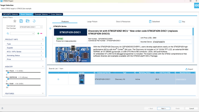

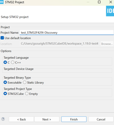

Hello @chachamaru
I am using STM32CubeIDE 1.19.0

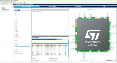

The IDE creates a project using the STM32F429I-Discovery board as requested. If you check the option “Initialize all peripherals with their default Mode”, the LTDC peripheral will be enabled automatically, as shown.
You are seeing the STM32F429ZIT6  MCU (LQPF144) because it is the microcontroller used on the Discovery board

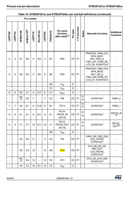

Regarding your question: "Pins like PI9 (VSYNC) and PI10 (HSYNC) do not appear in the Pinout view at all":
This is the expected behavior. According to DS9405 Rev 12, Table 10: STM32F427xx and STM32F429xx pin and ball definitions, PI9 and PI10 are not available on the LQFP144 package, which is used on the STM32F429I-Discovery board. Therefore, these pins do not appear in the Pinout view in STM32CubeIDE.
