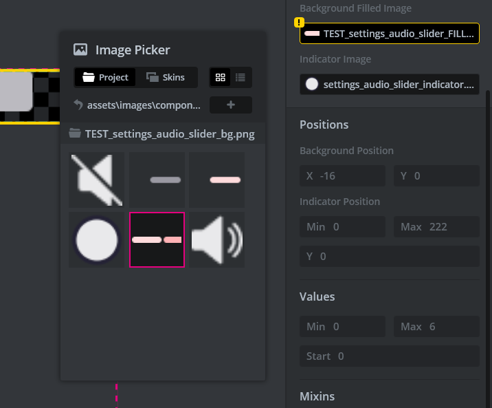

Issue: When adding new image to assets it appears as directory in TouchGFX Designer
2023-05-18 1:19 AM - edited 2023-11-20 5:09 AM
I found a bug or maybe a feature
When I add a new image to assets/images directory in my project it appears in the TouchGFX Designer but I cannot use it. It is so because it is shown as a direcotry, not an image file. Sometimes using Generate Code helps with that, sometimes I have to choose another image and when I again try to choose the new one it shows up as an image, not directory. Below you can see a screenshot showing this issue:

2023-05-22 5:16 AM
Hello @Community member,
Which version of TouchGFX are you using?
I'm personally using 4.21.4 and I'm not able to reproduce this bug.
/Yoann
2023-05-22 6:06 AM
I'm using TouchGFX 4.20. Could it be that this bug has been already fixed in the newest version? I haven't seen such a description in release notes.
