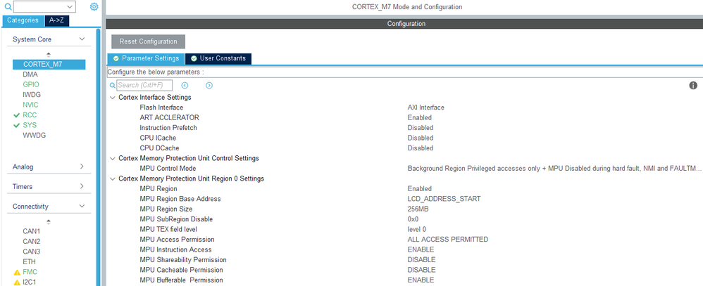

MPU is enable, and is set as follow

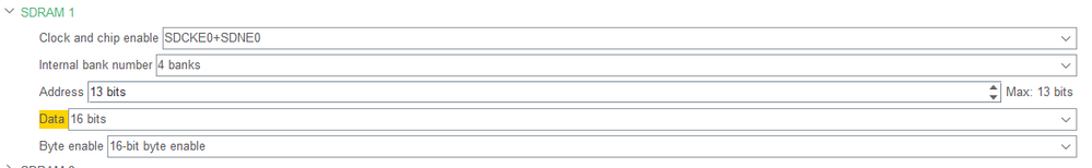

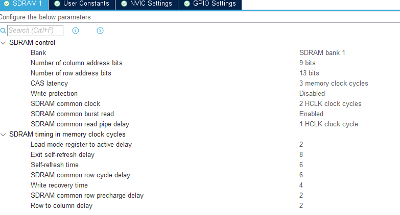

0693W000008xjrPQAQ.pngSDRAM is used and FMC is set as :

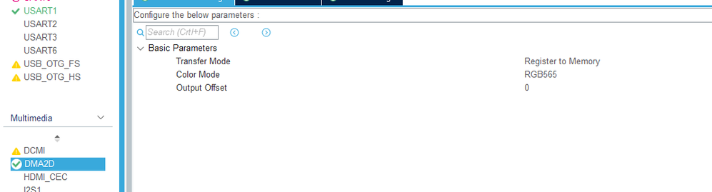

0693W000008xjroQAA.png0693W000008xjrpQAA.pngDMA2D is actived and set as :

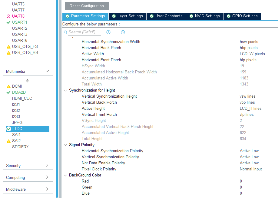

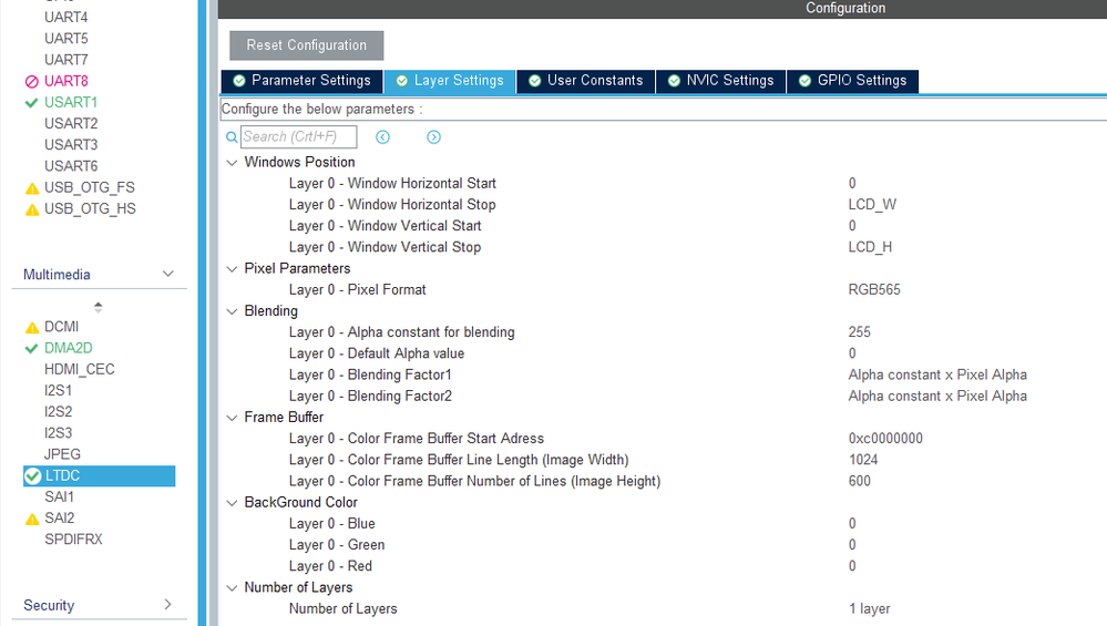

the LTDC is set as :
0693W000008xjswQAA.png0693W000008xjt1QAA.png​The following code is used to fill the LCD with color :
