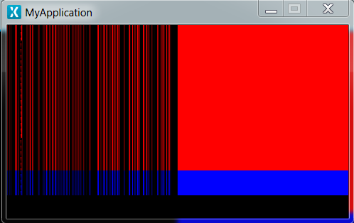

I did do some testing based on your post about the painter's render function (not using RenderingBuffer and Rasterizer which I mentioned above). I was able to paint a shape into a dynamic bitmap and display it, but it is not quite right. It has a number of vertical lines through it so I probably have something wrong with the increment of the pointer or possibly the "covers" parameter.
Here is a snippet of the code I used:
uint8_t* dynDataP = (uint8_t*)dynBmp.getData();
for(int y = 0; y < bmp_h; y++)
	shape1Painter.render((uint8_t*)dynDataP, 0, 0, y, bmp_h, 0);
	dynDataP+= bmp_h*bbp/ 8;
I am not sure what the parameter "covers" does and how to set it. Is there more documentation about that parameter somewhere?

Can you show me a screenshot of this?
Also, i don't blame you for being confused about "covers". The API doc says this:
     * @param covers   The coverage in of each pixel.
That's jibberish. It realates to coverage of each pixel in a scanline in a Canvas renderer. We are in the process of doing a complete review of all the API doc to remove deprecated functions and fix things, like this, that are completely wrong or difficult to understand.
I'll have to get back to you with a more precise definition and how you can use it in a more direct way like you're doing. Usually the Canvas class handles calling render and retrieving "covers" from a scanline.

Below is a screenshot of it running on the Simulator. I made the shape visible for demonstration purposes. The shape uses the 240x240 image on the right. The Image widget using the Dynamic Bitmap is on the left.
 I see that the Drawable class has a function drawToDynamicBitmap(), but assume that doesn't blend, and simply copies it over in the Dynamic Bitmap's memory?
