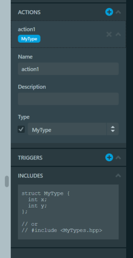

I apologize if I am missing the obvious, but is there a way to pass more than one value by way of an "action" to a Custom Container?
I am referencing the following tutorial:
https://support.touchgfx.com/docs/tutorials/tutorial-05/
I am working on a Custom Container with a Scrollwheel in it and I would like to add a custom action to be able to change the text of a specified element (a second parameter) programmatically. I tried the "custom" and when trying to add the action, I was not able to get it to accept a multiple parameter virtual function or when selecting "Execute C++ code".
Any help would be appreciated.
Best answer by Martin Stig STISSING
@scottSD​ Your input is really appreciated. We would like to make this more obvious.
What you can do for now:
Instead of having an action/method with two parameters, you could create an action/method that expects one struct parameter.
In Designer an example definition would be:
And an example usage would be:
Hope this helps.

I found out that when adding the "type", you can enter what types you want, separated by a comma. I had previously attempted to copy/paste a type with a variable from some code I was using:
Unicode::UnicodeChar* uCharText, uint8_t index
All that is necessary are the types:
Unicode::UnicodeChar* , uint8_t
Which creates a virtual function prototype in the base of the Custom Container:
virtual void SetElementText(Unicode::UnicodeChar* , uint8_t value);
And things work fine when calling this function.
Like I said, I was probably missing the obvious....
May 15, 2020
Hope this helps.
