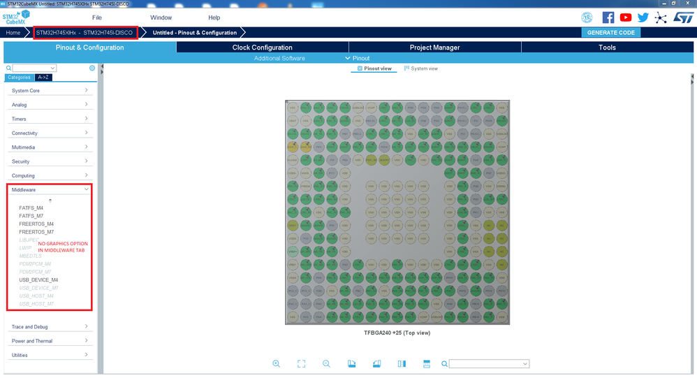

I have purchased "STM32H745I-DISCO" kit.
I would like to works with "TOUCHGFX" with "STM32H745I-DISCO" kit.
I select the "STM32H745I-DISCO" kit in "Board Selector" in "STM32CubeMx" software.
I have not found "GRAPHICS" option in "Middleware" TAB in "Pinout & Configration".
Can you please provide the some clarity on it.
How can i deal with "STM32H745I-DISCO" along with "TOUCHGFX".
Can you please provide me the steps that how to enable "GRAPHICS" option.
Please, do needful for me.

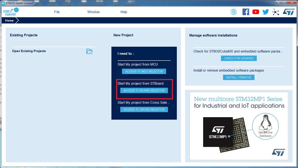

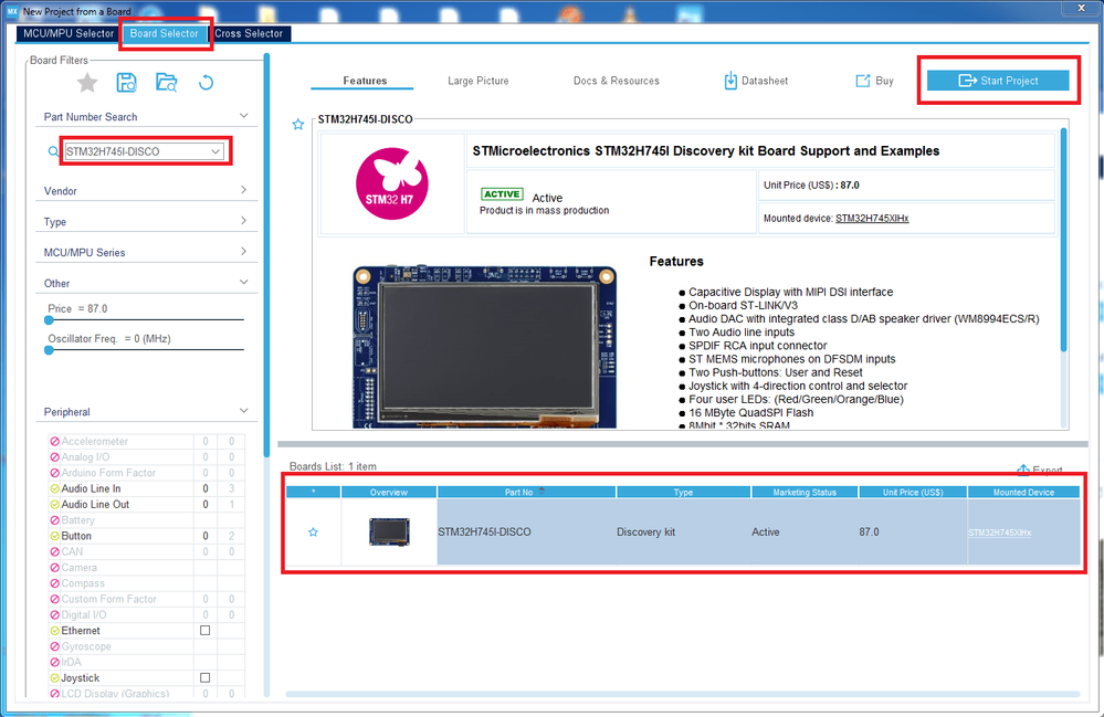

1. Open "STM32CubeMx" and click on "ACCESS TO BOARD SELECTOR".

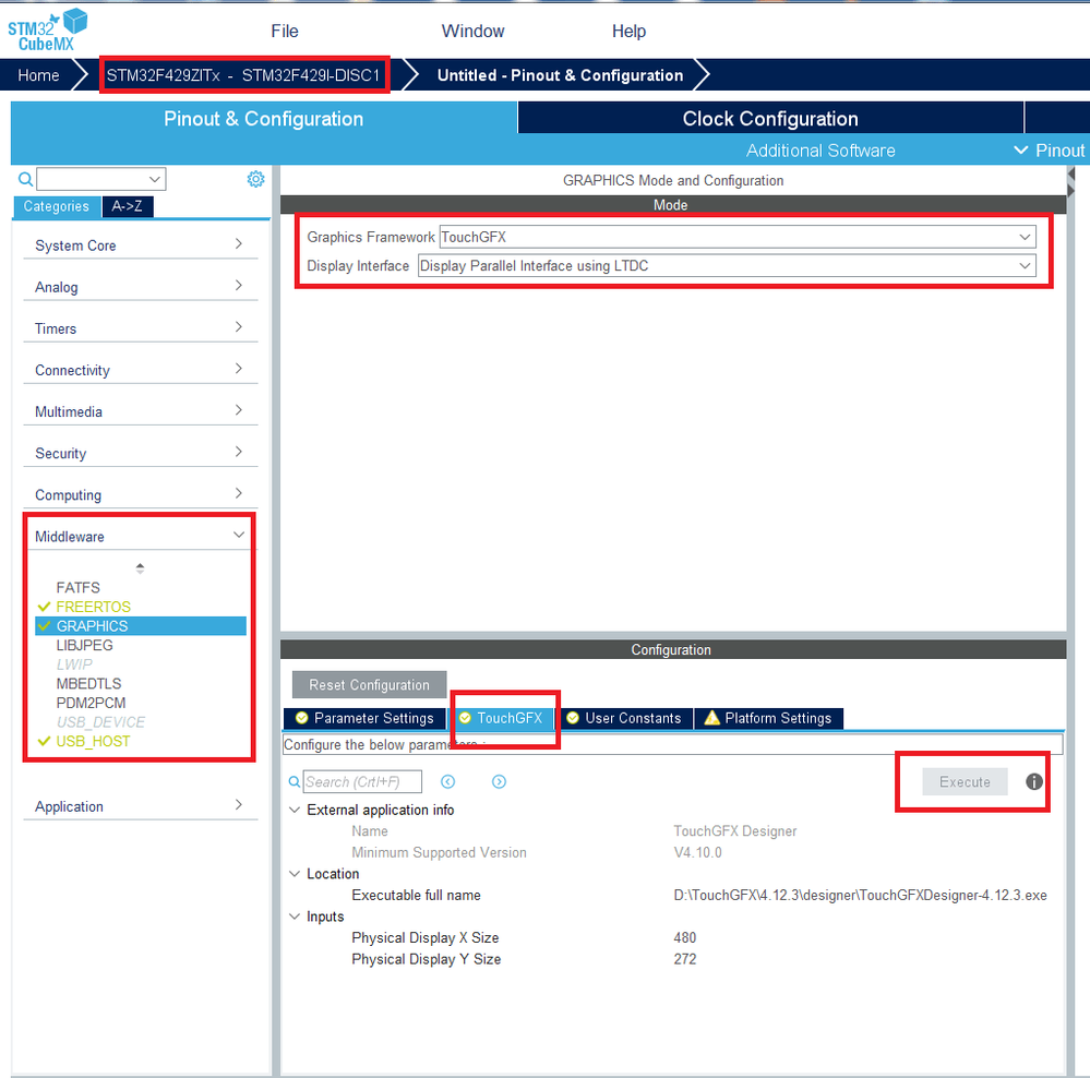

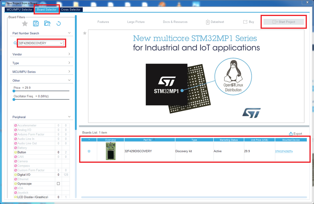

2. First, I am choosing the "STM32F429I-DISCOVERY" board, where I can find the "GRAPHICS" Option in the "Middle-ware" TAB, so I can able to choose the "TOUCHGFX" as Graphics Framework. please find the below snapshot.

4. Now, I am choosing the "STM32H745I-DISCO" board, where I can not find the "GRAPHICS" Option to works with "TOUCHGFX". please find the below snapshot.
Let me please clarify it.
Is something missing from my side?(Like Configuration)
Please do needful for me.
