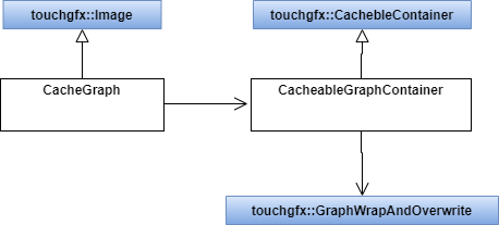

I inherit from image and want to display a dynamic bitmap on the image. The dynamic bitmap was previously populated by a CachableContainer.

We want to cache the bitmap of a graph and output it as an image. This is done for performance reasons for a ScrollWheel.
To do this, we insert the graph into a CachableContainer.
We create a separate dynamic bitmap for each CachableGraphContainer.
To update the graph, we call drawToDynamicBitmap(...).
The image should draw the data of the dynamic bitmap.
