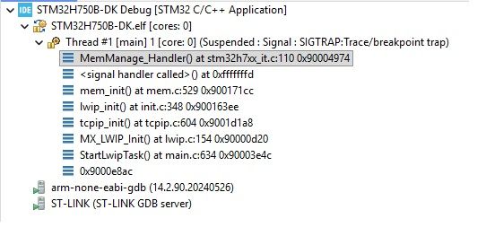

Thread Suspended: Signal: SIGTRAP:Trace/breakpoint trap
ksale.1
Senior II
This is a followup on this post https://community.st.com/t5/stm32-mcus-touchgfx-and-gui/compilation-error-macro-quot-bind-quot-requires-3-arguments-when/td-p/881690 . mƎALLEm provided very comprehensive answer for the issue. I was unable to post a reply hence this post. I've followed the solution to the letter using the guage touchgfx example. I got a blank white screen and this is the debug window: debug.jpg

  /* Local variables */
  /* MDMA interrupt initialization */
  /* MDMA_IRQn interrupt configuration */
  HAL_NVIC_SetPriority(MDMA_IRQn, 5, 0);
  HAL_NVIC_EnableIRQ(MDMA_IRQn);
/* FMC initialization function */
static void MX_FMC_Init(void)
  /* USER CODE BEGIN FMC_Init 0 */
  /* USER CODE END FMC_Init 0 */
  FMC_SDRAM_TimingTypeDef SdramTiming = {0};
  /* USER CODE BEGIN FMC_Init 1 */
  /* USER CODE END FMC_Init 1 */
  /** Perform the SDRAM2 memory initialization sequence
  hsdram2.Instance = FMC_SDRAM_DEVICE;
  /* hsdram2.Init */
  hsdram2.Init.SDBank = FMC_SDRAM_BANK2;
  hsdram2.Init.ColumnBitsNumber = FMC_SDRAM_COLUMN_BITS_NUM_8;
  hsdram2.Init.RowBitsNumber = FMC_SDRAM_ROW_BITS_NUM_12;
  hsdram2.Init.MemoryDataWidth = FMC_SDRAM_MEM_BUS_WIDTH_16;
  hsdram2.Init.InternalBankNumber = FMC_SDRAM_INTERN_BANKS_NUM_4;
  hsdram2.Init.CASLatency = FMC_SDRAM_CAS_LATENCY_3;
  hsdram2.Init.WriteProtection = FMC_SDRAM_WRITE_PROTECTION_DISABLE;
  hsdram2.Init.SDClockPeriod = FMC_SDRAM_CLOCK_PERIOD_2;
  hsdram2.Init.ReadBurst = FMC_SDRAM_RBURST_ENABLE;
  hsdram2.Init.ReadPipeDelay = FMC_SDRAM_RPIPE_DELAY_0;
  /* SdramTiming */
  SdramTiming.LoadToActiveDelay = 2;
  SdramTiming.ExitSelfRefreshDelay = 7;
  SdramTiming.SelfRefreshTime = 4;
  SdramTiming.RowCycleDelay = 7;
  SdramTiming.WriteRecoveryTime = 5;
  SdramTiming.RPDelay = 2;
  SdramTiming.RCDDelay = 2;
  if (HAL_SDRAM_Init(&hsdram2, &SdramTiming) != HAL_OK)
    Error_Handler( );
  /* USER CODE BEGIN FMC_Init 2 */
  /* Disable FMC Bank1 to avoid speculative/cache accesses */
  FMC_Bank1_R->BTCR[0] &= ~FMC_BCRx_MBKEN;
  BSP_SDRAM_DeInit(0);
  if(BSP_SDRAM_Init(0) != BSP_ERROR_NONE)
    Error_Handler( );
  /* USER CODE END FMC_Init 2 */

void StartLwipTask(void *argument)
  /* init code for LWIP */
  MX_LWIP_Init();
  /* USER CODE BEGIN 5 */
  /* Initialize the TCP echo server thread */
  tcpecho_init();
  /* Initialize the UDP echo server thread */
  udpecho_init();

 /* MPU Configuration */
void MPU_Config(void)
  MPU_Region_InitTypeDef MPU_InitStruct = {0};
  /* Disables the MPU */
  HAL_MPU_Disable();
  /** Initializes and configures the Region and the memory to be protected
  MPU_InitStruct.Enable = MPU_REGION_ENABLE;
  MPU_InitStruct.Number = MPU_REGION_NUMBER0;
  MPU_InitStruct.BaseAddress = 0x24000000;
  MPU_InitStruct.Size = MPU_REGION_SIZE_512KB;
  MPU_InitStruct.SubRegionDisable = 0x0;
  MPU_InitStruct.TypeExtField = MPU_TEX_LEVEL0;
  MPU_InitStruct.AccessPermission = MPU_REGION_FULL_ACCESS;
  MPU_InitStruct.DisableExec = MPU_INSTRUCTION_ACCESS_DISABLE;
  MPU_InitStruct.IsShareable = MPU_ACCESS_NOT_SHAREABLE;
  MPU_InitStruct.IsCacheable = MPU_ACCESS_CACHEABLE;
  MPU_InitStruct.IsBufferable = MPU_ACCESS_BUFFERABLE;
  HAL_MPU_ConfigRegion(&MPU_InitStruct);
  MPU_InitStruct.Number = MPU_REGION_NUMBER1;
  MPU_InitStruct.BaseAddress = 0x90000000;
  MPU_InitStruct.Size = MPU_REGION_SIZE_256MB;
  MPU_InitStruct.AccessPermission = MPU_REGION_NO_ACCESS;
  MPU_InitStruct.IsCacheable = MPU_ACCESS_NOT_CACHEABLE;
  MPU_InitStruct.IsBufferable = MPU_ACCESS_NOT_BUFFERABLE;
  MPU_InitStruct.Number = MPU_REGION_NUMBER2;
  MPU_InitStruct.Size = MPU_REGION_SIZE_128MB;
  MPU_InitStruct.DisableExec = MPU_INSTRUCTION_ACCESS_ENABLE;
  MPU_InitStruct.Number = MPU_REGION_NUMBER3;
  MPU_InitStruct.BaseAddress = 0xD0000000;
  MPU_InitStruct.Number = MPU_REGION_NUMBER4;
  MPU_InitStruct.Size = MPU_REGION_SIZE_32MB;
  MPU_InitStruct.Number = MPU_REGION_NUMBER5;
  MPU_InitStruct.BaseAddress = 0x30020000;
  MPU_InitStruct.Size = MPU_REGION_SIZE_128KB;
  MPU_InitStruct.TypeExtField = MPU_TEX_LEVEL1;
  MPU_InitStruct.Number = MPU_REGION_NUMBER6;
  MPU_InitStruct.BaseAddress = 0x30040000;
  MPU_InitStruct.Size = MPU_REGION_SIZE_512B;
  MPU_InitStruct.IsShareable = MPU_ACCESS_SHAREABLE;
  /* Enables the MPU */
  HAL_MPU_Enable(MPU_PRIVILEGED_DEFAULT);

please advise
1 REPLY 1
ksale.1
Senior II
Please note the provided guage example works fine as is no problems whatsoever
