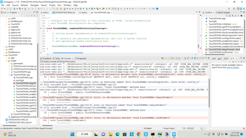

I uses touchGFX associated with Cube IDE with ETH, lwip freertos , it is compiling ok and working. But found ETH gpio pin of ETH in ioc, the max speed is setting to low, so I change it to veryhigh , rebuid the code found a new TouchGFX folder is created automatically, and cause compiing error:
i.e. error: no declaration matches

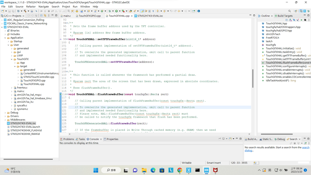

1, initial case, ok and working

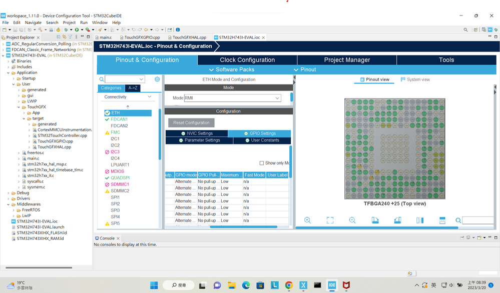

0693W00000aJIH2QAO.png2, foung ETH GPIO speed is low

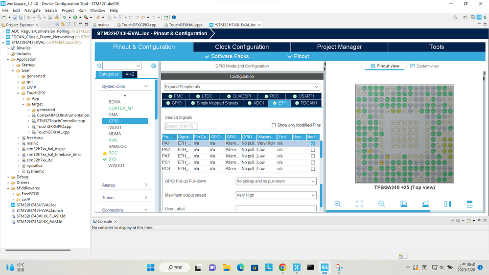

0693W00000aJI0KQAW.png3, change speed
0693W00000aJI1kQAG.png4, rebuild the code, there are new folder (Drivers, LWIP, Middleware and TuchGFX) created automatically at low location , then cause many error as below
0693W00000aJIIUQA4.pngI have no clue regaring such kind of symptom, please advice, thanks in advance.
