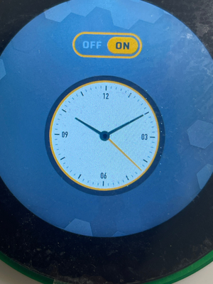

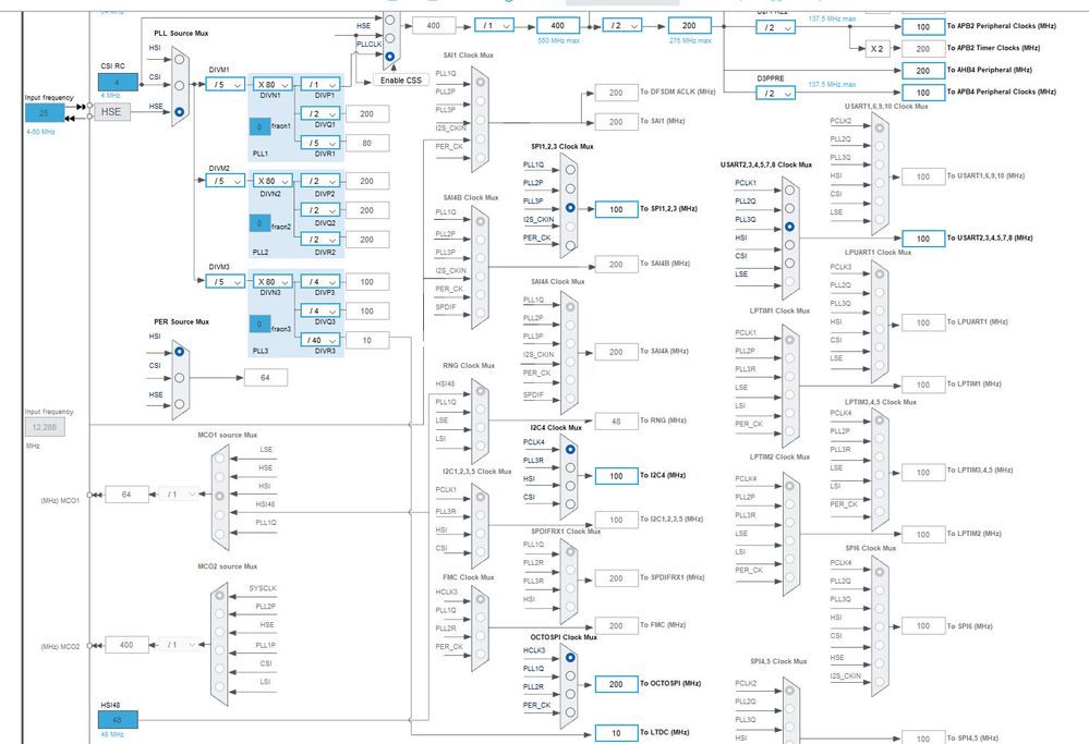

As title, I have a custom board using STM32H723ZGT6, RGB666 LCD (480 * 480) with LTDC interface, the framebuffer used external Octo SPI PSRAM APS12808L-3OBM-BA of APMemory. I can display image using TouchGFX, but the image always noisy with some green pixels ramdom, I try with others image, but it still appear (see image)
Below is my configuration for system clock, OSPI, LTDCAPS12808

System clock

2024-06-05 11:15 PM
Hello @KDJEM.1
The good news
I tried as you recommended in the link above: adding a 120-ohm resistor to the CLK and RWDS pins of the PSRAM. The green pixels are no longer appearing (although there are still some white pixels in a line, but this problem is really solved) (see image below). Once again, I am very grateful for your help! :smiling_face_with_smiling_eyes:
