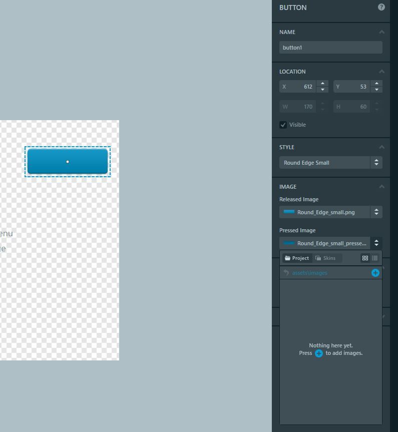

I am try adding image on my application with new TouchGFX Designer version. I added image in assets file in project. I can see added image to "Images" tab. But I can't see anything in project tab of widgets image selection.
How can i solve this problem?

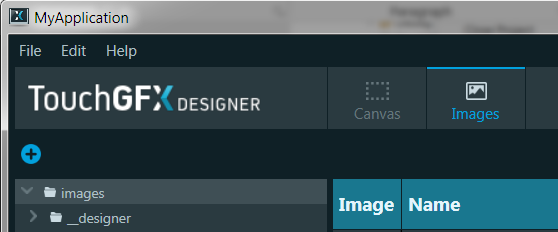

It appears image adding functionality has changed. It took me a bit to figure it out as well. At the top of the Designer is an "Images" tab (I believe this tab is new in 4.12.3):0690X00000AqebzQAB.png
In this area you are able to drag and drop an image or you can click the "(+)" which opens a dialog to explore and add an image.

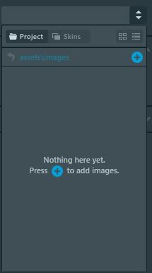

After the image is added, it will show up in the Image Properties dialog "assets\images" window (in the uploaded picture in your post).

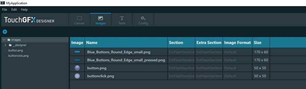

Actually I am tried to say that. I can see my images in there. I can add image this section. But all my added images can't see in the Image Properties dialog "assets\images" window.
There is also another situation like that; I can see images when I want to change old added widget image. But when I add a new widget I can't see any picture in widgets properties.
