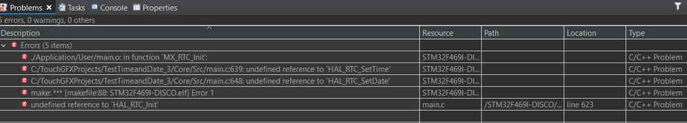

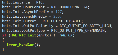

Im new to CubeIDE. When Setting up RCC (Low speed clock) to crystal resonator and adding clock and calendar in RTC, it says the HAL_RTC_Init is not defined.. how can I fix this?

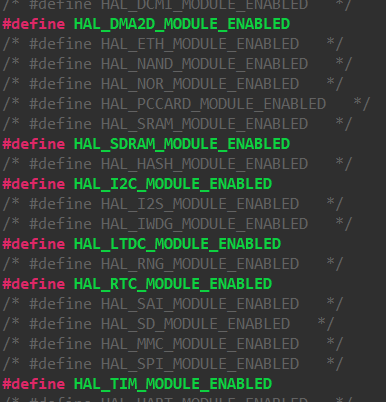

It means that the HAL RTC files haven't been included. Open up the *_hal_conf.h file and RTC module is enabled with the line:
#define HAL_RTC_MODULE_ENABLED

@TDK​
As in, put this line in main? If so it still shows the same error.
Amaresh
@TDK​ if u mean to enable it looks like it is already enabled
No, in *_hal_conf.h. The line should already be in there, ensure it's not commented.
Include your IOC file if you can, or project code.
Amaresh
Yes the above picture in inside hal_conf.h as you can see the second last define shows it has been enabled by default.
I'm not sure, looks like it should be working. Can you post the exact error message(s) you're getting?
