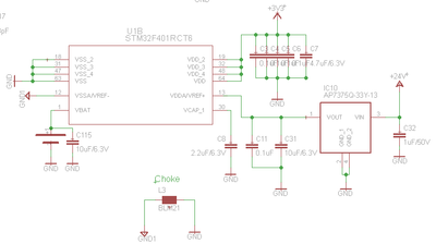

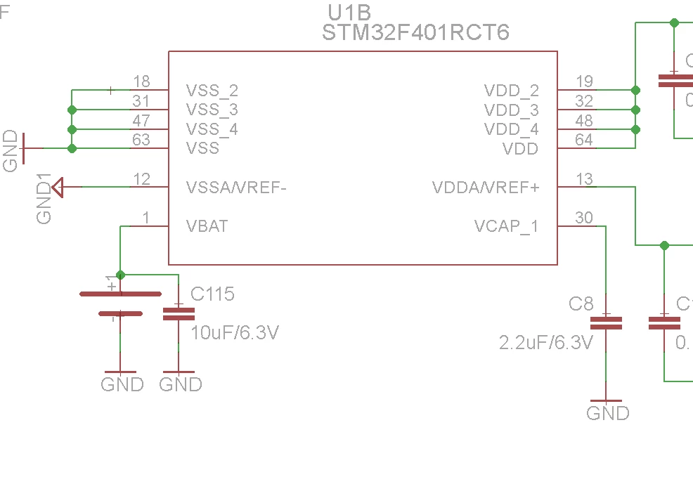

Here is the schematic of my RTC circuit.

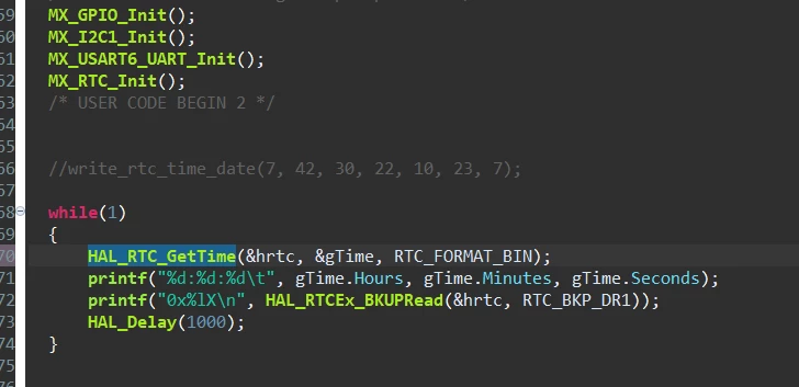

Main Code:
Here is my RTC init function:

VDDA/VREF+ is connected exactly how?
KBhon.1
KBhon.1Author
October 22, 2023
@waclawek.jan Thanks for the reply.
VDDA/VREF+ are connected together and are powered by using a separate LDO power supply. This is done to keep analog and digital voltages separate. Also, I would like to mention that VSSA/VREF- are connected together and are shorted to digital Gnd using a choke. This is done to keep analog and digital Gnds on separate sides (but still connected using choke).
Here is how the supplies are:
The please note in the image below VSSA/VREF- are on separate GND node and the choke L3 is used to connect both the digital and analog Gnds.
GLASS
Visitor II
October 22, 2023
Seems that vdda is not correctly decoupled. IC10 is on GND and not GND1.
having a digital ground "separated" from analog ground is a good routing practice to avoid high speed return current from digital altering analog ground. But Agnd and Gnd MUST be connected with LOW impedance in one point (Star).
F4 need that vdda is "near" vdd. Look at datasheet. So may be give a try shorting L3 and deliver vdda from vdd through a choke. Not using a dedicated LDO that is challengy to guaranteed vdda "near" vdd as required by F4...

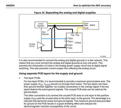

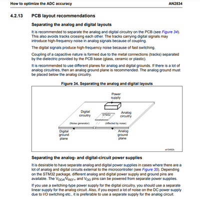

However we have followed ST app note AN2834 to design analog circuitry. On page 42, 43 it clearly suggests to keep analog and digital supplies separate and to connect analog and digital Gnds at one single point as we did using choke.
Here is the link for app note (Page 42,43)
https://www.st.com/resource/en/application_note/an2834-how-to-optimize-the-adc-accuracy-in-the-stm32-mcus-stmicroelectronics.pdf
Here I have attached its screenshots
I can remove choke on GND line and short them directly, however in our another test board there is no such choke but still it gives the same RTC problem. I really do not want to merge VDDA and VDD, since keeping them separately has impacted hugely on our analog reading section.

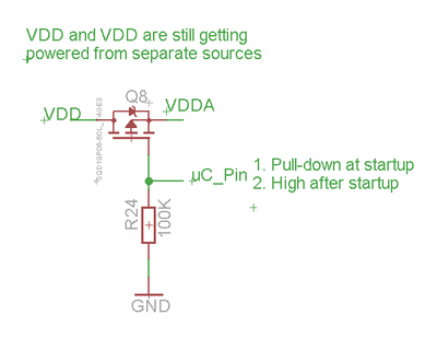

To confirm I get you correctly, Is this how you want me to test your 2nd option?
In this, I am considering
1. VDD and VDDA are still getting power from separate sources.
2. Keep mosfet pulled down at first and then give high to disconnect both the supplies.
AScha.3
October 22, 2023
right.
mos could be something like this: SI2367DS-T1-GE3  sot23
(at mouser: 30ct, 66 mOhm rds-on)

First, you are using the HAL_RTC_GetTime() improperly. Read the HAL documentation. Second, the HAL_RTC_Init() in the current latest CubeF4 v1.27.1 still reinitializes the RTC on every call and therefore looses seconds. Third, there really is no way of reading the RTC values properly with the HAL/Cube broken bloatware. Read this:
https://community.st.com/t5/stm32-mcus-embedded-software/32f417-rtc-errata-sheet-if-reading-subseconds-is-this-code-ok/m-p/207827
And everything related to RTC there: http://www.efton.sk/STM32/gotcha/
