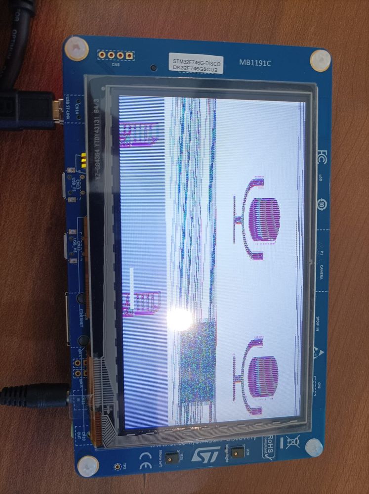

i have STM32F746 Discovery kit with me.I tried to load the Touch GFX Code from the cube MX example and the LCD output is blur. Can any one help me with this issue.

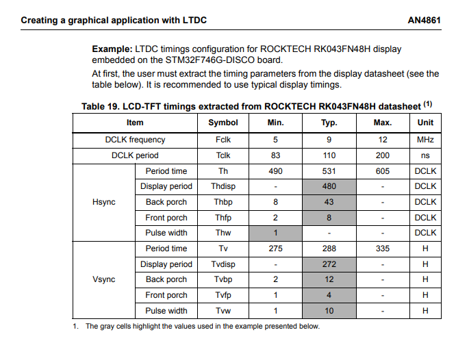

Please try Checking the Display Colors​ to make sure that your display colors configuration is correct.
You can also check your LTDC configuration from the AN4861 (LTDC parameter/layer settings, LTDC clocks and timings configuration...).
