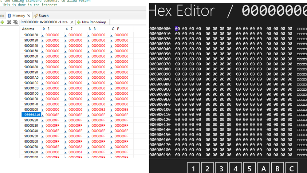

yes, what I see matches my bin file: 0693W00000VOWyjQAH.png
I just realized something in the console I am getting this error message some of the time. "Error: Data mismatch found at address 0x90000000 (byte = 0x99 instead of 0x00)" strange thing is when I actually view the memory I am seeing the correct value.
well, it seems like I can erase and write to it, but reading sometimes gives me an error. Another strange thing is: I can use st-link to read the memory correctly all the time; however the st-programmer fails to read the memory correctly. (they are using the same custom loader).
I propose to decrease clock for QUADSPI in loader and the project.
thanks. I will try that in a few days. some more info: if I lower the frequency of CubeIde or the CubeProgrammer I can program and verify the QSPI flash without any problem.
