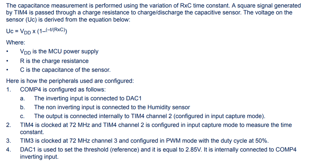

I seek help (It could be my code or electronic setup) to achieve capacitance measuring application using STM32G4. The application is outlined in the note "AN4232" --> Section 3.5 "Humidity measurement". There is a project example of this application but sadly only for the STM32F3 firmware package --> Comparator project examples --> COMP_HYGROMETER.
I am not interested in measuring humidity, but this application relies on measuring the capacitance (My goal) from which the humidity is determined. I think (but ignorant of the exact details) I am right in saying that this application relies on the charging/discharging of a foreign/external capacitor and the combination of a single comparator + single DAC as a voltage reference for the comparator + two TIM modules, one can determine the time-constant of the external capacitor from which you can determine the capacitance itself. I configured a STM32G431KB-Nucleo board project and followed the steps outlined in the application AN4232. I can't read a useful capacitance value.
0693W00000GZgCSQA1.png0693W00000GZgDBQA1.png0693W00000GZgKWQA1.pngHere is literally what the application says on how the capacitance is measured + How to configure your peripherals:

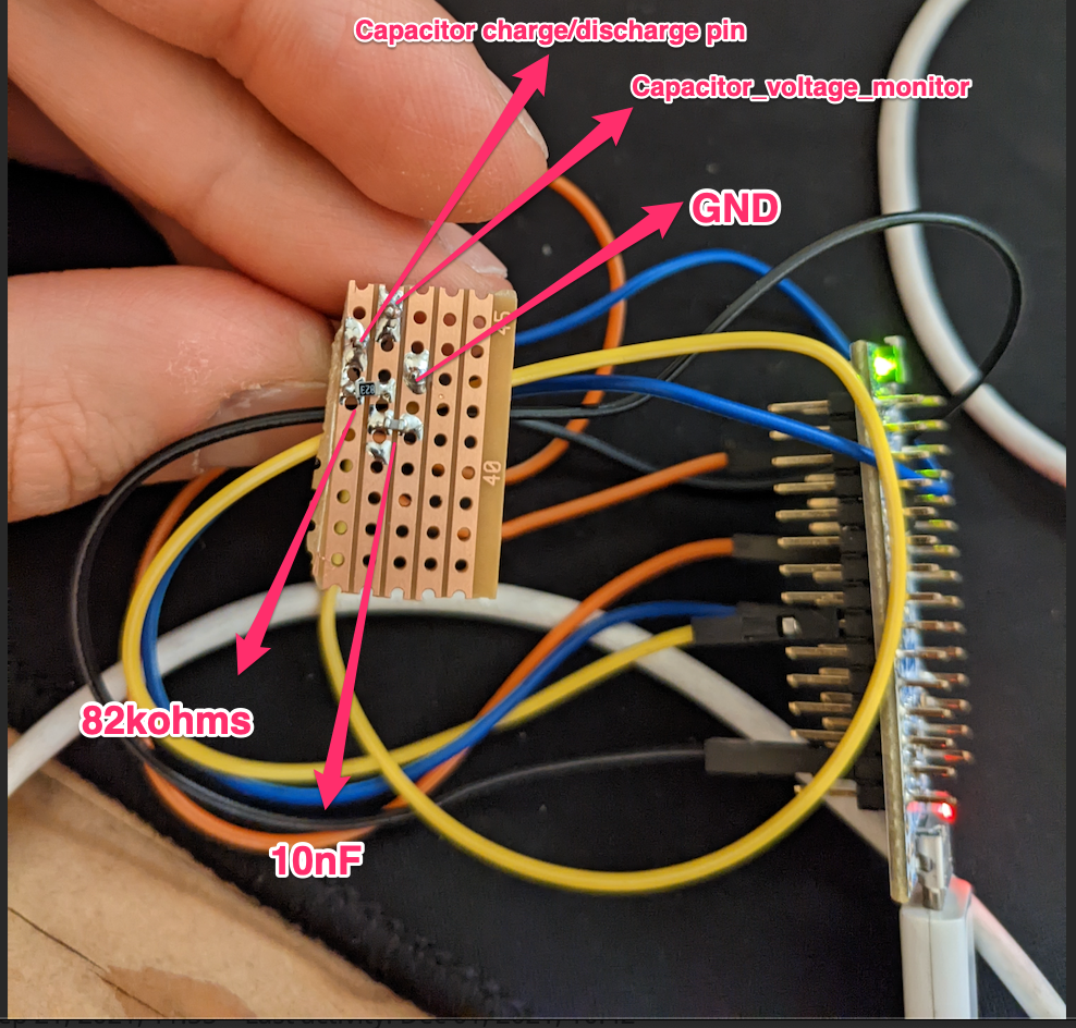

Actually after a second thought, I don't need these lines, since they rely on having a "Reference Capacitor" available on the STM32F3 board to measure ICError which I don't actually have. Well The only capacitor I have attached is the 10nF so this is pointless. my new main has this removed:

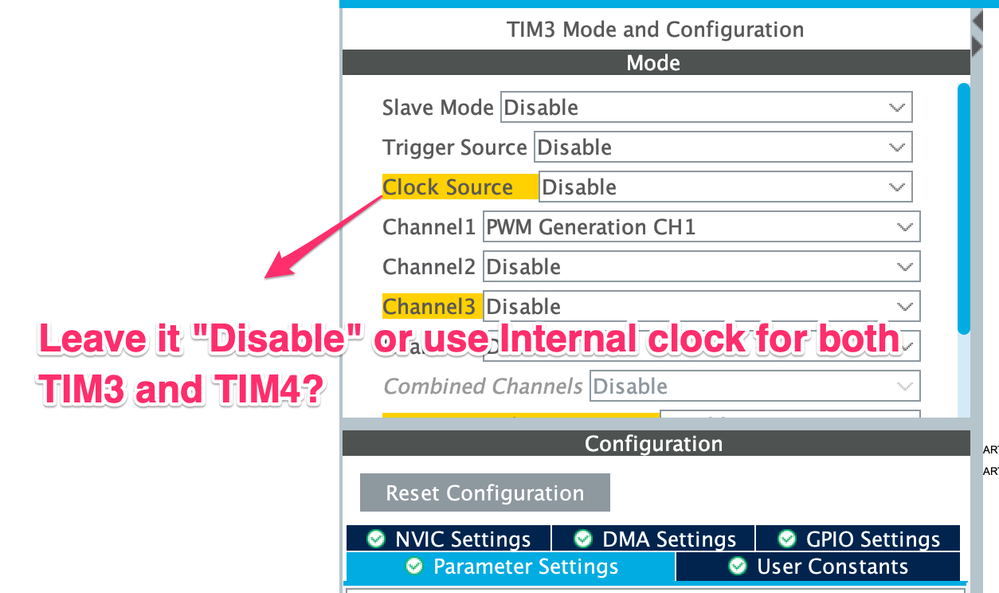

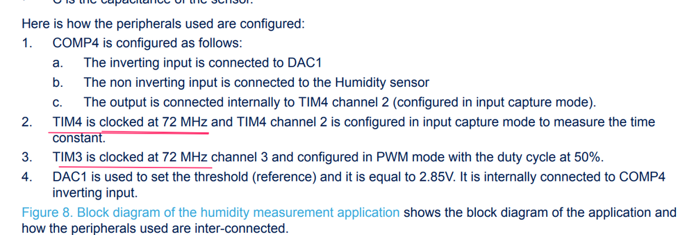

So there is one thing I don't understand here, in the application note AN4232, it says TIM3 and TIM4 are "CLOCKED" @ 72Mhz which is the internal clock of that STM32F3. but after examining their code project example "COMP_HYGROMETER" it seems as if TIM3 and TIM4 aren't using any clock source? so I am wondering here shall I feed my TIM3 and TIM4 with my internal 170MHz STM32G4 clock?
As for your question, yes I do actually go past while(AvrgICReadValue == 0); Only if I don't setup TIM3 and TIM4 with any clock at all:
Here is what the application note says:
Eitherway, when I do feed TIM3 and TIM4 with the internal clock fo 170MHz I simply don't go past while(AvrgICReadValue == 0);.

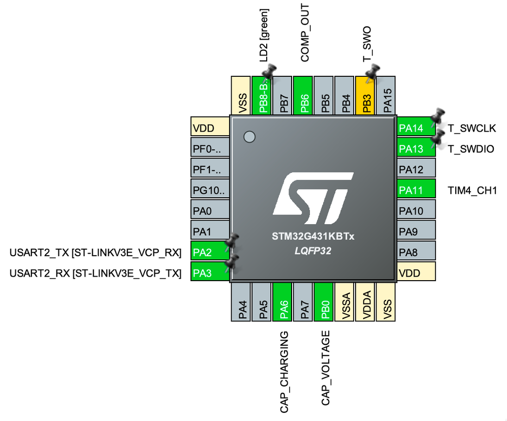

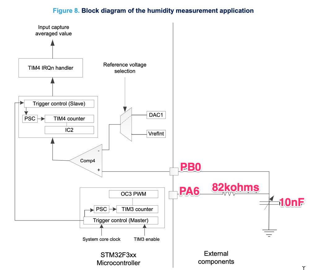

Hi i dont know this example , but in your code i dont see start PWM .
In teory if TIM3 is 16bit tim then result freq signal is 72M/65536 equal to PWM period, and duty need set to half aka 50%
but primary on source MCU example is pin and timer chanel used together, Pin connected to RC have alternative TIM3 CH3 func usw.
As i write in first message , run PWM and measure pin connected on your design to 82k rezistor. Need see here square ...
