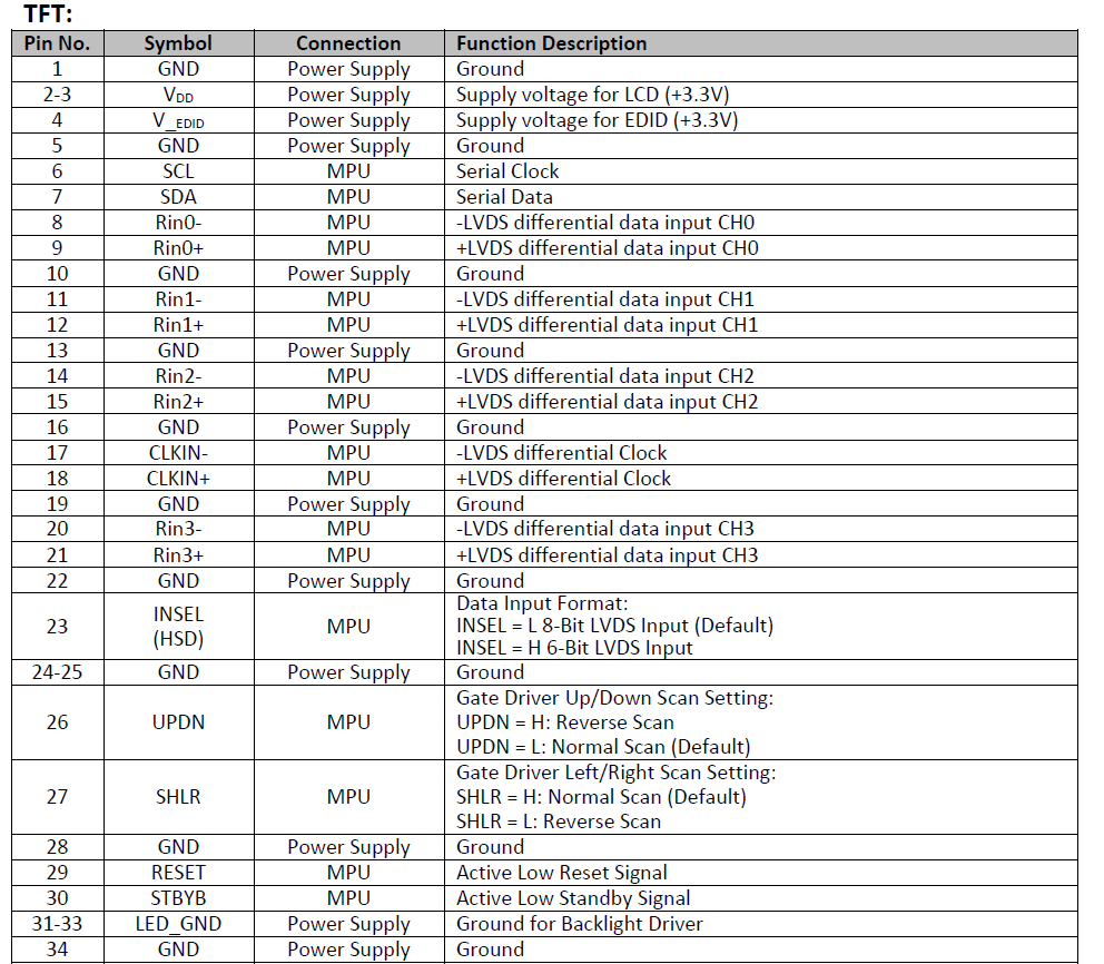

I'm a beginner; i want to use STM32F767ZI board to connect it to an TFT-LCD 10,1' display with capacitive touchscreen like this
.First if is possible i want to know a link that explain to me the protocol that i need to be connected to an LVDS-display.
I read stm32 (not completly) doc en.STM32F7_Peripheral_LTDC.pdf and en.DM00287603.pdf(AN4861).
In this doc i find that LTDC give out data in parallel mode:
* if i want to connect to an LVDS dispaly i need a chip to translate the information?
#ltdc-to-lvds-display?- Labels:
LCD-LTDC

wow that is so expensive... and not Mipi, so I think you are barking up the wrong tree there...
check this brand:
https://www.buydisplay.com/default/tft-display/10-1-inch
LVDS is easy to use but be careful with track layout, its 6/8channels x 300MHz or there abouts...
do you need a super active display ?
you can go a little bit slow with this one : Also not Mipi.
this is your selected display: how many LVDS channels ? 4+clock
now check the processor:
The DSI Host is a dedicated peripheral for interfacing with MIPI® DSI compliant displays. <- your issue
? Maximum resolution of 800x480 pixels:
? Maximum resolution is limited by available DSI physical link bandwidth:? Number of lanes: 2 (You need 5 channels for LVDS...)? Maximum speed per lane: 500 Mbps1Gbps- Mark as New

Hello, I want to use the same STM32 MCU to controll a TFT with LVDS interface, so I don't know how I should connect the TFT pins into the MCU.
There are a MCU that have a LVDS pins that connect directly with TFT or I need a Converter of LVDS to RGB connector to connect the TFT to RGB pins in order to use LTDC library?
I put here the datasheet of TFT: https://eu.mouser.com/datasheet/2/271/Microtips%20Technology-8-28-2017-MTD0801PZL%20spec1-1181493.pdf
‎2018-10-02 9:59 PM
This is an LVDS display,you need a RA8877 chip, or something like it.
60MHz pixel clock will be ok.
‎2018-10-08 11:43 PM
Use a RGB interface TFT or add a RGB to LVDS chip. EXP. TI DS90C385​
