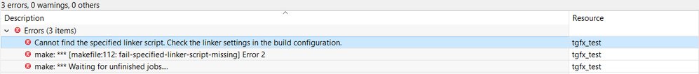

I am currently looking to start a TouchGFX 4.15 project inside the STM32CubeIDE but it is not as straight forward as I was hoping. My knowledge in some of the areas required to make it work are lacking so I'm hoping this thread will help me learn more as well as solve my problem. I am also new to STM32CubeIDE.
First, after creating the project and selecting my P-Nucleo-WB55 board, I immediately added the software pack for TouchGFX version 4.15, and enabled it along with the CRC that was required. Without adjusting any of the settings I went to debug and was presented with this list of errors

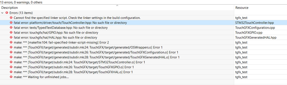

0693W000006ENdrQAG.png So I added the include path "C:\TouchGFX\4.15.0\touchgfx\framework\include" to the project. I also opened up the TouchGFX project and generated the initial code (just a screen with a button). Now I'm presented with this error.
0693W000006ENksQAG.png Does this issue with the linker have to do with TouchGFX generating C++ code while everything else is written in C?

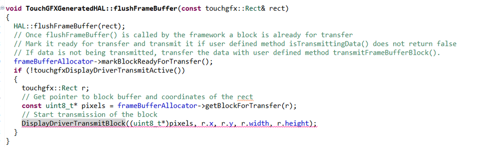

Ok a couple of things...
1) I was able to solve my linker problem by going to properties->C/C++Build->Settings->Tool Settings->MCU G++ Link and fixing the linker script so that it matches the correct linker script. This got messed up for me after adding the TouchGFX package for some reason.
2) After solving that issue, I was presented with another issue saying the file bits/c++config.h couldn't be found. So I included a path to that file as well.

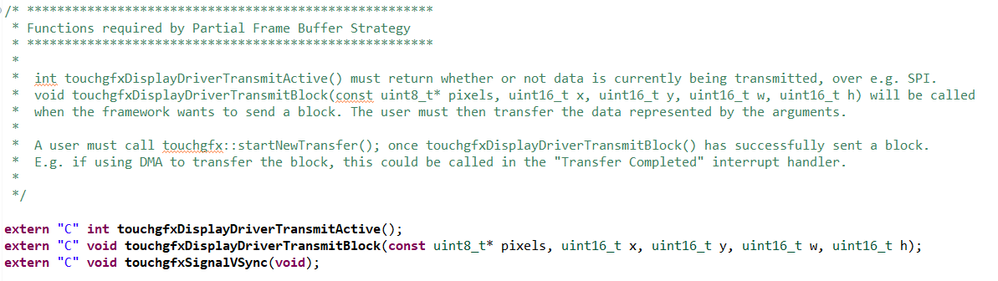

3) Now it seems that there is an issue with the TouchGFX file generator. It seems that the file 'TouchGFXGeneratedHAL.cpp' has generated the externs correctly
0693W000006EPewQAG.pngbut for some reason generates the actual function call incorrectly
Only the partial frame buffer functions seems to be affected.
