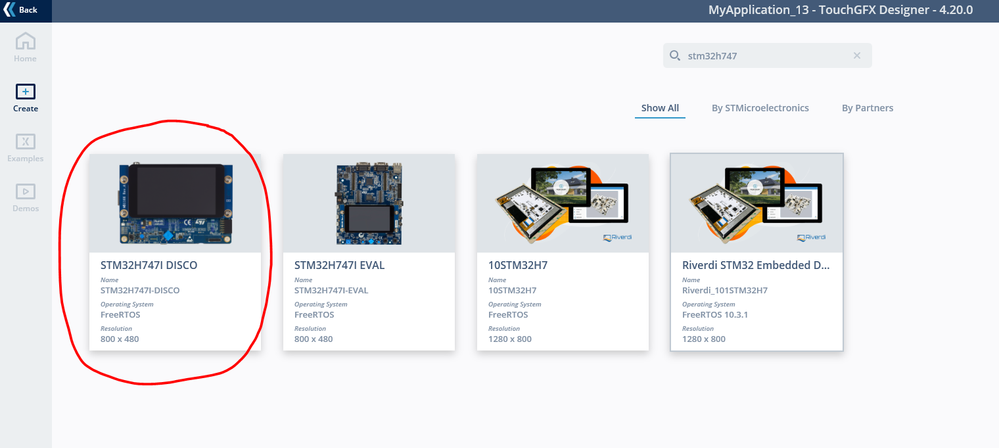

We want to use STM32H747I board in the end, but we don't know TouchGFX inside out.
First of all, we made logo screen at simulator and try importing into STM32H747I, but didn't succeed.
Is there a way to import project?

Hello @HNish.2 ,
You can create a project and select the STM32H747I TouchGFX board setup, and then import the UI you already created inside this new project. Then you will have the UI you want running both on simulator and on target.
