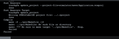

i'm successful to drive RGB LCD 480*272 with stm32cube IDE , but if i change to touchGFX and load into target , it have some following error , remark: simulator is OK

hello, everyone! I use a customed LCM driver board with STM32H750ZBT6 to drive a RGB_LCD that resolution is 480*272 , The LCD is normal and successful to drive when i generate the code with stm32CubeIDE ,  but if i generate the code with CMFile , using touchGFX to create UI , it have some error list under touchGFX

Are you sure your makefile file is in that directory? , search for it and do the 'make' while youre in that path

Hello @miker ,
It seems you are using CMake toolchain.
You can only build and flash from TouchGFX Designer if you use STM32CubeIDE toolchain (gcc).
To build and flash using CMake, you should :
  1. Generate code in TouchGFX Designer
  2. Open the project in VS Code (with the STM32 extension) or use a terminal with CMake and Ninja/Make
  3. Build the project using the CMake build system
  4. Flash the board using STM32CubeProgrammer, ST-LINK Utility, or the VS Code extension
