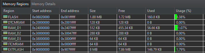

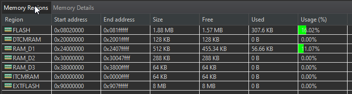

Here are the memory assets when I have the project configured for internal flash...
_legacyfs_online_stmicro_images_0693W00000bjYOyQAM.pngand here is how the linker script is configured of course..

Then I see the memory usage change to this as expected.
_legacyfs_online_stmicro_images_0693W00000bjYTZQA2.pngHowever, this does work...when I debug the application it seems to go to hard fault from the touchgfx_init....

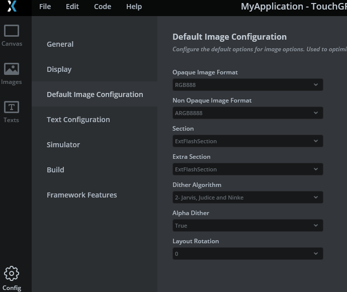

Any ideas as to what may be going on here? Not aware of anything else that must be setup in TouchGFX when using external memory, the image configuration in TouchGFX is already set to ExtFlashSection.
