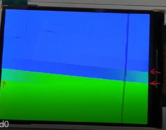

Is it possible to change partial buffer drawing from pixel rows to columns?
I have partial buffer allocated for 3 rows (lines), so that lines 1-3 are drawn first, then lines 4-6, 7-9 ...
I would like to change it to rows: rows 1-3 first, then 4-6....
Background:
Our display has native orientation in columns (we use it rotated by 90 degrees) and the fact that TouchGFX generates update by rows and display is refreshed column-wise causes very visible diagonal tearing effect. Having the tear line vertical would be less irritating.
Thanks,
Petr

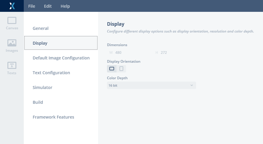

Hello @PWagn.1​ ,
Just to be sure, did you try to change your display orientation in TouchGFXDesigner ?
It could be a way to achieve what you want.
Go to Config>Display>Display orientation.
/Yoann
