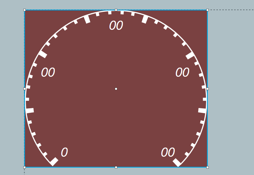

I am makeing a gauge background out of many circle widgets. I dont want to use static immage background because the position of segments can change depending on the maximum rpm.
I have create this in TouchGFX designer and for each circle widget Designer created also a painter. Therefor there are many painter that have the same color configuration. Is it possible to eliminate some widgets and/or painters to reduce the memory consumption.
part of generated code CustomGaugeBackgroundBase.cpp
    segmentBig1.setPosition(0, 0, 494, 426);
    segmentBig1.setCenter(247, 246);
    segmentBig1.setRadius(235);
    segmentBig1.setLineWidth(22);
    segmentBig1.setArc(-136, -133);
    segmentBig1.setCapPrecision(180);
    segmentBig1Painter.setColor(touchgfx::Color::getColorFrom24BitRGB(255, 255, 255));
    segmentBig1.setPainter(segmentBig1Painter);
    segmentBig8.setPosition(0, 0, 494, 426);
    segmentBig8.setCenter(247, 246);
    segmentBig8.setRadius(235);
    segmentBig8.setLineWidth(22);
    segmentBig8.setArc(134, 137);
    segmentBig8.setCapPrecision(180);
    segmentBig8Painter.setColor(touchgfx::Color::getColorFrom24BitRGB(255, 255, 255));
    segmentBig8.setPainter(segmentBig8Painter);
    segmentBig2.setPosition(0, 0, 494, 426);
    segmentBig2.setCenter(247, 246);
    segmentBig2.setRadius(235);
    segmentBig2.setLineWidth(22);
    segmentBig2.setArc(-98, -95);
    segmentBig2.setCapPrecision(180);
    segmentBig2Painter.setColor(touchgfx::Color::getColorFrom24BitRGB(255, 255, 255));
    segmentBig2.setPainter(segmentBig2Painter);
    segmentBig3.setPosition(0, 0, 494, 426);
    segmentBig3.setCenter(247, 246);
    segmentBig3.setRadius(235);
    segmentBig3.setLineWidth(22);
    segmentBig3.setArc(-59, -56);
    segmentBig3.setCapPrecision(180);
    segmentBig3Painter.setColor(touchgfx::Color::getColorFrom24BitRGB(255, 255, 255));
    segmentBig3.setPainter(segmentBig3Painter);
    segmentBig4.setPosition(0, 0, 494, 426);
    segmentBig4.setCenter(247, 246);
    segmentBig4.setRadius(235);
    segmentBig4.setLineWidth(22);
    segmentBig4.setArc(-21, -18);
    segmentBig4.setCapPrecision(180);
    segmentBig4Painter.setColor(touchgfx::Color::getColorFrom24BitRGB(255, 255, 255));
    segmentBig4.setPainter(segmentBig4Painter);
    segmentBig5.setPosition(0, 0, 494, 426);
    segmentBig5.setCenter(247, 246);
    segmentBig5.setRadius(235);
    segmentBig5.setLineWidth(22);
    segmentBig5.setArc(18, 21);
    segmentBig5.setCapPrecision(180);
    segmentBig5Painter.setColor(touchgfx::Color::getColorFrom24BitRGB(255, 255, 255));
    segmentBig5.setPainter(segmentBig5Painter);
    segmentBig6.setPosition(0, 0, 494, 426);
    segmentBig6.setCenter(247, 246);
    segmentBig6.setRadius(235);
    segmentBig6.setLineWidth(22);
    segmentBig6.setArc(57, 60);
    segmentBig6.setCapPrecision(180);
    segmentBig6Painter.setColor(touchgfx::Color::getColorFrom24BitRGB(255, 255, 255));
    segmentBig6.setPainter(segmentBig6Painter);
    segmentBig7.setPosition(0, 0, 494, 426);
    segmentBig7.setCenter(247, 246);
    segmentBig7.setRadius(235);
    segmentBig7.setLineWidth(22);
    segmentBig7.setArc(95, 98);
    segmentBig7.setCapPrecision(180);
    segmentBig7Painter.setColor(touchgfx::Color::getColorFrom24BitRGB(255, 255, 255));
    segmentBig7.setPainter(segmentBig7Painter);
    circleOut.setPosition(0, 0, 494, 426);
    circleOut.setCenter(247, 246);
    circleOut.setRadius(245);
    circleOut.setLineWidth(3);
    circleOut.setArc(-136, 135);
    circleOut.setCapPrecision(180);
    circleOutPainter.setColor(touchgfx::Color::getColorFrom24BitRGB(255, 255, 255));
    circleOut.setPainter(circleOutPainter);
    segmentSmall1_1.setPosition(0, 0, 494, 426);
    segmentSmall1_1.setCenter(247, 246);
    segmentSmall1_1.setRadius(240);
    segmentSmall1_1.setLineWidth(10);
    segmentSmall1_1.setArc(-128, -126);
    segmentSmall1_1.setCapPrecision(180);
    segmentSmall1_1Painter.setColor(touchgfx::Color::getColorFrom24BitRGB(255, 255, 255));
    segmentSmall1_1.setPainter(segmentSmall1_1Painter);
    segmentSmall1_2.setPosition(0, 0, 494, 426);
    segmentSmall1_2.setCenter(247, 246);
    segmentSmall1_2.setRadius(240);
    segmentSmall1_2.setLineWidth(10);
    segmentSmall1_2.setArc(-121, -119);
    segmentSmall1_2.setCapPrecision(180);
    segmentSmall1_2Painter.setColor(touchgfx::Color::getColorFrom24BitRGB(255, 255, 255));
    segmentSmall1_2.setPainter(segmentSmall1_2Painter);
    segmentSmall1_3.setPosition(0, 0, 494, 426);
    segmentSmall1_3.setCenter(247, 246);
    segmentSmall1_3.setRadius(240);
    segmentSmall1_3.setLineWidth(10);
    segmentSmall1_3.setArc(-111, -113);
    segmentSmall1_3.setCapPrecision(180);
    segmentSmall1_3Painter.setColor(touchgfx::Color::getColorFrom24BitRGB(255, 255, 255));
    segmentSmall1_3.setPainter(segmentSmall1_3Painter);
    segmentSmall1_4.setPosition(0, 0, 494, 426);
    segmentSmall1_4.setCenter(247, 246);
    segmentSmall1_4.setRadius(240);
    segmentSmall1_4.setLineWidth(10);
    segmentSmall1_4.setArc(-103, -105);
    segmentSmall1_4.setCapPrecision(180);
    segmentSmall1_4Painter.setColor(touchgfx::Color::getColorFrom24BitRGB(255, 255, 255));
    segmentSmall1_4.setPainter(segmentSmall1_4Painter);
    segmentSmall2_1.setPosition(0, 0, 494, 426);
    segmentSmall2_1.setCenter(247, 246);
    segmentSmall2_1.setRadius(240);
    segmentSmall2_1.setLineWidth(10);
    segmentSmall2_1.setArc(-90, -88);
    segmentSmall2_1.setCapPrecision(180);
    segmentSmall2_1Painter.setColor(touchgfx::Color::getColorFrom24BitRGB(255, 255, 255));
    segmentSmall2_1.setPainter(segmentSmall2_1Painter);
    segmentSmall2_2.setPosition(0, 0, 494, 426);
    segmentSmall2_2.setCenter(247, 246);
    segmentSmall2_2.setRadius(240);
    segmentSmall2_2.setLineWidth(10);
    segmentSmall2_2.setArc(-80, -82);
    segmentSmall2_2.setCapPrecision(180);
    segmentSmall2_2Painter.setColor(touchgfx::Color::getColorFrom24BitRGB(255, 255, 255));
    segmentSmall2_2.setPainter(segmentSmall2_2Painter);
    segmentSmall2_3.setPosition(0, 0, 494, 426);
    segmentSmall2_3.setCenter(247, 246);
    segmentSmall2_3.setRadius(240);
    segmentSmall2_3.setLineWidth(10);
    segmentSmall2_3.setArc(-73, -75);
    segmentSmall2_3.setCapPrecision(180);
    segmentSmall2_3Painter.setColor(touchgfx::Color::getColorFrom24BitRGB(255, 255, 255));
    segmentSmall2_3.setPainter(segmentSmall2_3Painter);
    segmentSmall2_4.setPosition(0, 0, 494, 426);
    segmentSmall2_4.setCenter(247, 246);
    segmentSmall2_4.setRadius(240);
    segmentSmall2_4.setLineWidth(10);
    segmentSmall2_4.setArc(-65, -67);
    segmentSmall2_4.setCapPrecision(180);
    segmentSmall2_4Painter.setColor(touchgfx::Color::getColorFrom24BitRGB(255, 255, 255));
    segmentSmall2_4.setPainter(segmentSmall2_4Painter);
    segmentSmall3_1.setPosition(0, 0, 494, 426);
    segmentSmall3_1.setCenter(247, 246);
    segmentSmall3_1.setRadius(240);
    segmentSmall3_1.setLineWidth(10);
    segmentSmall3_1.setArc(-49, -51);
    segmentSmall3_1.setCapPrecision(180);
    segmentSmall3_1Painter.setColor(touchgfx::Color::getColorFrom24BitRGB(255, 255, 255));
    segmentSmall3_1.setPainter(segmentSmall3_1Painter);

Hello manto.1,
Unfortunately there's not too many option. The only thing that you can maybe try is to do a half of your image and try to do a "mirroring" on it. It should be possible with an AbstractPainter but I never tried it. But I'm not sure if you'll always have a symmetry on your gauge, if not, this solution will not work.
Else I don't see other solution than changing your scale instead of changing the position of your segments, or use a static image background.
