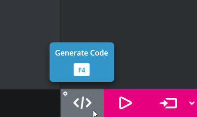

Once you have created you desired GUI, simply click on "Generate code" on the bottom right corner:

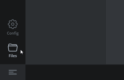

Then you can simply open the folder of your project on the bottom left:
