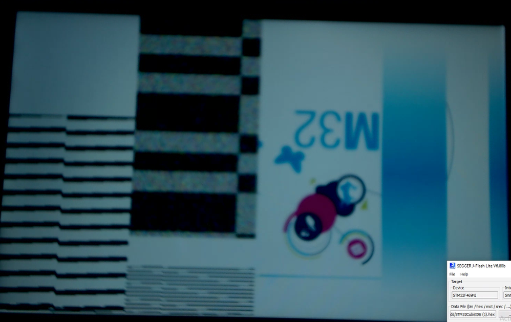

I have tried configuring my project based on tutorials you gave for my STM32F469 Discovery board. For a test I have just added an image on screen but it looks like only half of the image displayed. please find an attached image.

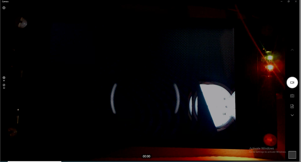

0693W00000AQ1GWQA1.pngI have also tried to run clock example but that is also having weird behavior.
Petr DAVID
Hello Keyur Thumar,
I would recommend you to first try some ready examples to determine if it could be HW related problem or if it is problem in your software. In the STM32F4Cube FW package could be found some ready to use examples. For example:
  • \Projects\STM32469I-Discovery\Demonstrations\TouchGFX
  • \Projects\STM32469I-Discovery\Applications\Display
Keyur Thumar
Thanks Petr for the answer.
Clock example is from the ready use on TouchGFXDesigner. That is also distorted.
STemWin examples are running fine on them. I want to configure it for TouchGFX.
