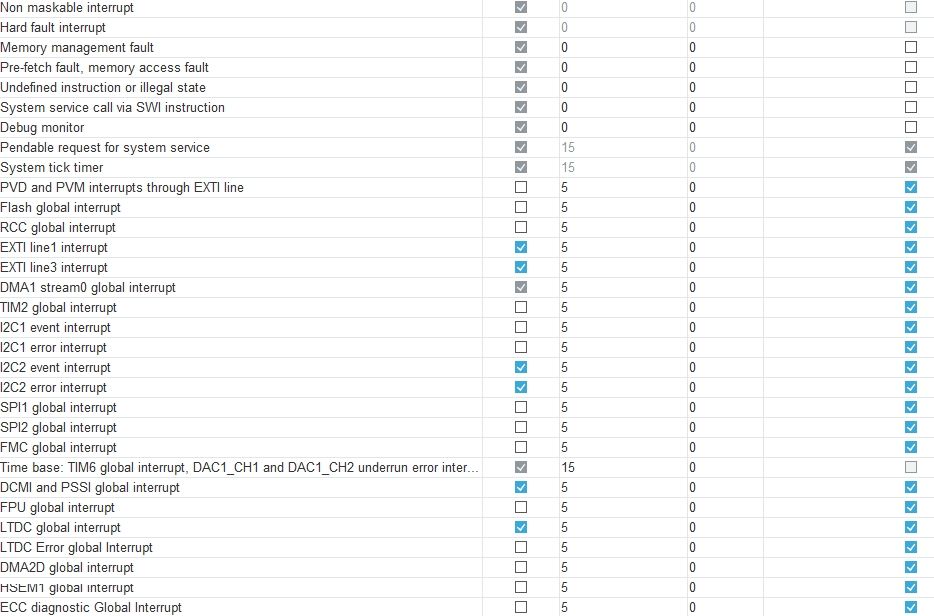

The problem is that the processor gets into an infinite loop a short while after executing jpeg_start_decompress (jpeg_startDecode does not return in any case, but the time is kinda "random"). The infinite loop comes from this assert:
//port.c
configASSERT( ucCurrentPriority >= ucMaxSysCallPriority );
//ucCurrentPriority is 144 here and ucMaxSysCallPriority is 244.
//FreeRTOSConfig.h
#define configASSERT( x ) if ((x) == 0) {taskDISABLE_INTERRUPTS(); for( ;; );}
The interrupt triggering this was the LTDC global interrupt. LTDC LineEvent to be exact.

I really don't see any problem with the interrupt priorities here.
Does someone has an idea what went wrong here?
Thanks in advance!
