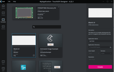

hi,
I created a simple project with TouchGfx 4.22.1 for STM32F746G-DISCO and added a label to check whether the LCD worked.
However, the LCD did not display anything after downloading the code. According to the log of compiling the code as below, the file of 'stm32746g_discovery_lcd.c' in Drivers/BSP/STM32746G-Discovery/ was not compiled or included in the project. And the lcd driver is designed for RK043FN48H LCD while it should be KUNJIAN HT043C,
May I know if there are any sample codes which can be run on the STM32F746G-DISCO version C01? Thanks.

Hell @hbZhao ,
In theory, boards are shipped with an application that you can find in the firmware packs.
In your case that would be something like: C:\Users\YOUR_USER_NAME\STM32Cube\Repository\STM32Cube_FW_F7_V1.17.1\Projects\STM32746G-Discovery
Let me know if you find it.

hbZhao
Hello, @Osman SOYKURT
Thanks for your kind reply.
Since most of boards in the store should be the version C01, which has been upgraded many components from version B, it would be the best if the TouchGFX can generate codes directly with the board version C01.
As the demo application worked well when the board was arrived, may I know where I can download the codes of demo application?
Appreciate your help. Best Regards.
