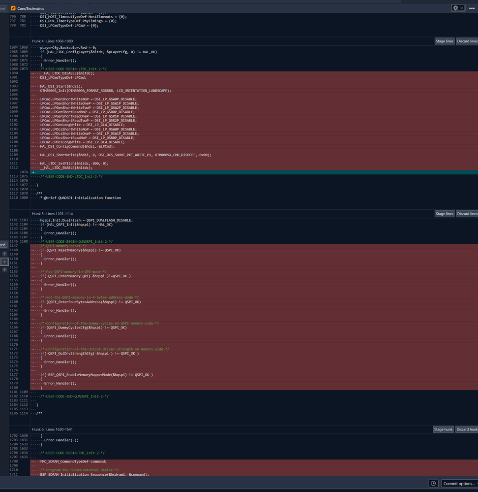

Hi, I'm going to necro-bump this topic because I somewhat randomly came across it again. I think this happens because for some reason when you check the peripheral pair box and regenerate, CubeMX removes code within User Code labels, including that which is responsible for setting up DSI, LTDC, QSPI and FMC in certain TouchGFX application templates, fyi @Martin KJELDSEN​ .
Here's my Git diff after checking the box, generating, and then unchecking the box then generating again. Red lines denote removals that occurred after the first generation, and persisted after the second. The whole list is about twice as long as shown in the screenshot. @Imen DAHMEN​ this is a fairly serious issue with CubeMX that should get another look. Using CubeIDE 1.6.0 with CubeMX plugin Version: 6.2.0-RC3.

I'm still trying to understand what you are trying to do as well. From what the CubeMX team told me the "Generate peripheral initialization as a pair of .c/.h files" option is not moving sections from the already generated initialization files but rather re-initializing peripheral in the main.c file ( the already .c peripheral initialization files will be removed). So the changes in User code related to peripheral initialization will not be moved nor saved, but the user sections that are not related to periphel initialization will be kept. (quite annoying to be honest since if you click it out of curiosity you just get rid of your code without realizing it :grinning_face_with_sweat:)
/Romain
