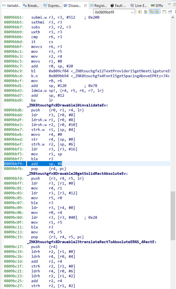

Finally, the LR register points to a Flash address at 0x809bbf9. Going into the disassembly, we can see the following instructions around that address :
0693W00000Ho17uQAB.pngThe Hard Fault thus seems to be triggered by the function "touchgfx::Drawable::invalidate()" called before the screen transition. However, for me, the trail stops there since putting any breakpoint into the source/assembler code within the invalidate() function stops the process of the code and is thus never reached.

Good debugging effort so far.
Does the problem always occur on the same screen? Can you reproduce the issue on a clean, minimal project? If so, does it also occur with a similar minimal project on an ST dev board? Unfortunately the further away from known hardware, the harder it is to remotely answer without deeper knowledge of your project.
It's important to note that just because the hardfault occurred during the TouchGFX process, doesn't mean the source of the problem causing the hardfault was TouchGFX. I recommend isolating the TouchGFX task and gradually re-enabling other tasks until the issue begins presenting.
The only times I've had hard faults when changing screens specifically the issue was related to an improperly flashed QSPI holding the graphics assets. But it wasn't sporadic, like your issue seems to be.
Good luck.
