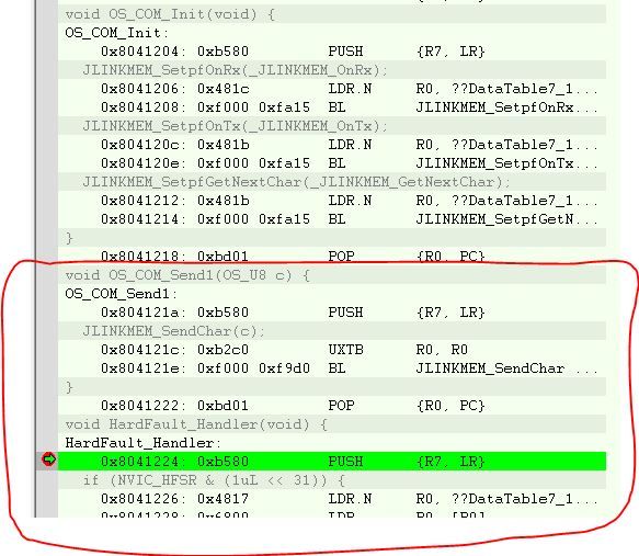

The code was running on the STM32F429I-Disco board. It was a huge help, allowing me to develop a lot of code while waiting for my prototype. Kudos to the ST team who developed the board. Regarding the HardFault, I'm guessing it is a stack issue. Looking at the disassembly, I see a JLINKMEM_SendChar function/macro. That function/macro results is implemented using a UXTB instruction, and a BL instruction. Those instructions are followed by a stack pop that I'm guessing should provide the destination address for the branch instruction. Immediately after that pop, the ARM core jumps to the HardFault handler.

Now if it faults on the pop it's more indicative that the stack frame has been corrupted. You could inspect the memory pointed to by SP/R13, and the value of R13 itself. If R13 is outside the scope of the current stack, that is a problem. In Keil the stack size is specified in startup_stm32fxxx.s, is usually small, and can get corrupted if heap access ploughs into the bottom of the stack, or by statically defined variables if the stack drops below it's limit.Up vote any posts that you find helpful, it shows what's working..
