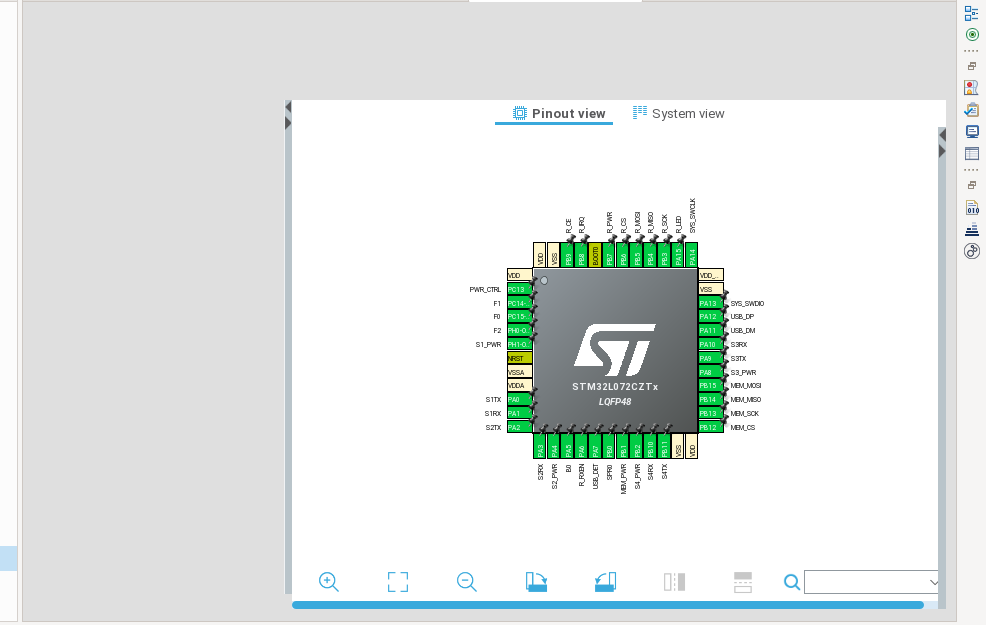

I have some more feedback on this issue.
If I run my Linux GUI as X11, MX is very slow, but usable. It goes faster if I disconnect it from the internet.
However, if I run the GUI as Wayland it is unusable -
After 45 minutes it get this far
Just the image of the device. No controls are active.Just the image of the device. No controls are active.

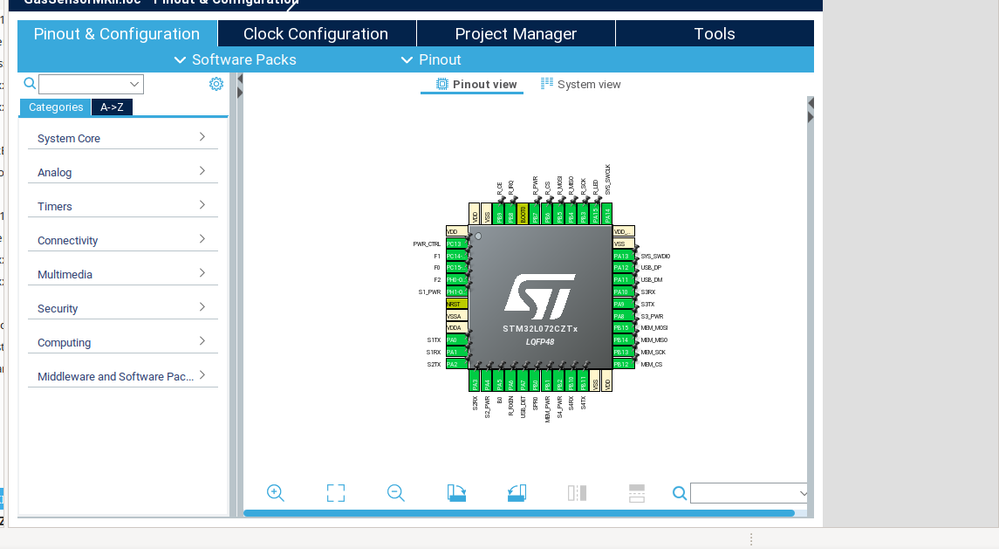

After 2 hours 30 minutes I get -
 None of the controls are active yet.

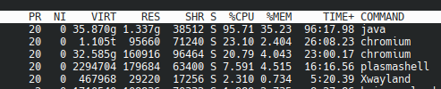

All this time Java, and its chrom'ies, are going flatout -
All my CPU cores are max'ed out. Temperature has max'ed out. The fan sounds like my laptop is going to morph into a hoover craft and take off...
