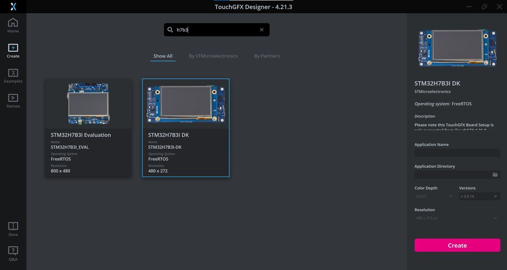

Hello @Ayoub_Bnina ,
Are you working on a custom project that you have made in STM32CubeMX and trying to enable TouchGFX on it?
Or are you using a TouchGFX Board Setup and you are facing the issue?
TouchGFX provides Board Setups for users to develop GUI for their applications easily and download it onto the board.
STM32H7B3I-DK Borad SetupSTM32H7B3I-DK Borad Setup
 You can see an example of how it is done here .
I hope this helps
Mohammad MORADI
