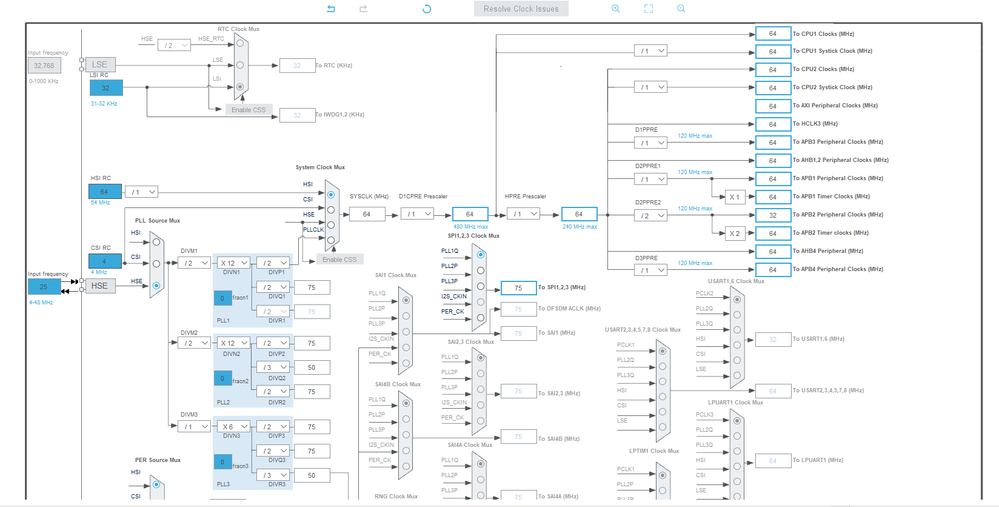

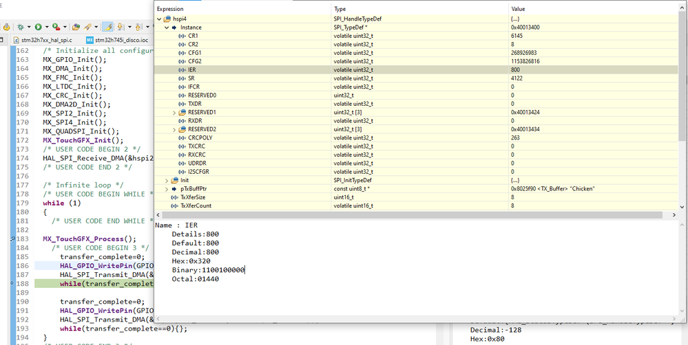

I am using the STM32H745XIH6 board and I have setup SPI using CubeMX in CubeIDE and for some reason, the HAL_SPI_Transmit_DMA never calls the HAL_SPI_TxCpltCallback unless I put a HAL_Delay after the function.

transfer_complete=0;
HAL_SPI_Transmit_DMA(&hspi4, TX_Buffer, sizeof(TX_Buffer));
//HAL_Delay(1); //Needs to be inserted so that transfer_complete = 1
while(transfer_complete==0){};

Did you check EOTIE interrupt is set? TXC is generating the interrupt?
‎2023-07-10 4:06 AM
Certainly. Please find file attached.
As for EOTIE, I can see it is not set to 1 for some reason while I debug it...
But when I run it, it seems that the HAL_SPI_TxCpltCallback is getting called because I inserted HAL_GPIO_TogglePin(GPIOI, GPIO_PIN_13); inside it and I can see the LED blinking...
Somehow the result from debug is different from Run...what is the reason for that?
