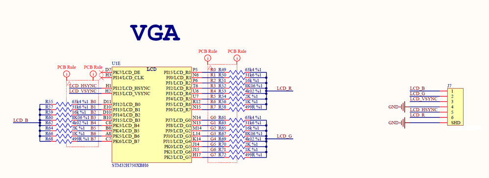

For the additional information my used VGA circuit scheme is here;0693W000006EjbYQAS.png
I did it step by step like you said and found the problem. My problem root cause is in external crystal. Probably hardware is wrong assembled. I select HSI clock an all problem is solved.
Thank you for helping.

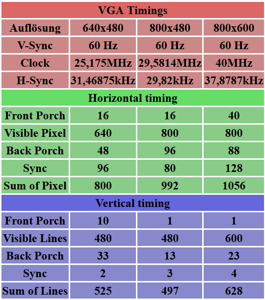

I using this configuration for VGA setting;
https://www.dasrotemopped.de/bilder/stm32f429i-disco_vga-timing.png
Now found this document too;
https://www.embeddedartists.com/wp-content/uploads/2018/06/Display_Expansion_Board_Users_Guide.pdf
I will try both settings. I will write the results.
