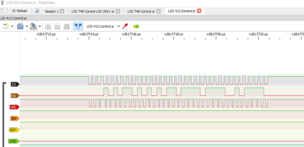

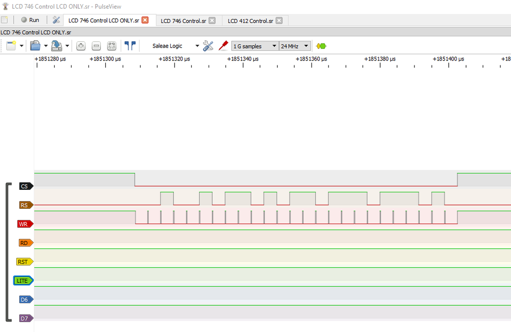

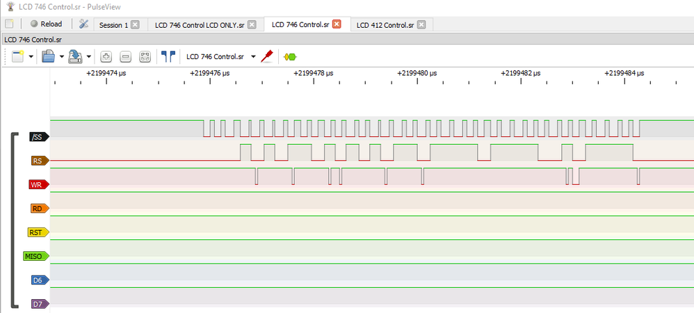

I have a LCD display working on a nucleo F412 using FSMC. I'm trying to move to a nucleo F746. I have moved the code and includes from the 412 to the 746 project and connected the display to the correct pins for the 746. The 746 pin out is a little different than the 412 for the default connections. I have the same clock speeds and settings. I compared the FMC init function line by line between the two and all the setting match, but I can't get the display to work using the 746. Using a logic analyzer and comparing the two boards running the same code I can see there are differences on the FMC A18,FMC_NE1,FMC_NWE and FMC_NOE pins. The logic analyzer is sampling at 24MHZ. I've moved the display jumpers for the display back to the F412 and it works, back to F746 making sure to adjust for the differences in the pins a few times now. Any idea's where or why the display works on the F412 but the same settings, clock speeds and code won't work on the F746?

It's took a bit but it's working now. I got a new probe so I can see what is going to the LCD and decode the values. About every third write to the LCD was a bad value that would write immediately before or after a good value. It would do the same with the memory swap and writing to 0xC000'0000 and the default 0x6000'0000. I left the memory swap and code so it would write to 0xC000'0000. I thought maybe the Nucleo board had a solder jumper, or a UART/Debug or some other signal interfering. So I used the same code and made sure I could just send a 0x00, 0x01, 0x02, 0x04.. 0xF0 to the LCD. That was all good. I picked about 5 or 6 real commands for the LCD like 0x28, 0xC5 and I could send those out one at a time when debugging, but when running at normal speeds I'd get random values again. I was pretty convinced that it must need more address setup time , data setup time, buss turn around etc. I tried enabling the Extended mode values and still about every third value was incorrect. I disabled the Extended mode, put the bus turn around time, data setup time and address setup time back to the previous values and started adding 1ms delays between commands and the display started working. No more random commands were showing up. I started removing the delays to isolate where things went bad, but ended up taking all the delays out, speeding up the set up times etc. and the display kept working. I commented out the memory swap, changed the code to write to 0x6000'0000, about every third value is incorrect again. I've confirmed a few times now the memory swap is needed and without it bad commands show up. I'm not sure why things changed and worked like it should at that particular point, It seems like the MCU was holding a grudge from 4 days ago when I wrote an incorrect value to the SYSCFG_MEMRMP. :) Thanks for letting me know about this setting and the rest of the help.

I started a new project and only enabled the FMC for the F746 to make sure I didn't have some other interrupt or code getting in the way. I maxed out clock setup times to slow things down also. I'm not sure why NE1 signal would change from a toggle during communication at faster speeds to staying low during communication at a slower speed. The LCD still doesn't work when connect to the F746. I ordered a new probe with 16 channels so I can capture all the signals and timing and decode the data. Some screen shots below for the same command. Let me know if you have anything I should look at.
