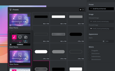

Hello @Marc_LM and welcome to the community!
Indeed, this feature is not available yet.
It has already been brought to our attention and we will therefore, in order to increase user satisfaction, implement a solution in a further release.
But note that this is not a priority as there is an easy walkaround : using an image with rounded corners.
This can be done for buttons (design the image yourself and add it to the image field of the button), box (simply add an image instead of the box), etc.

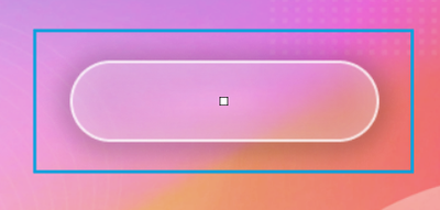

Furthermore, there already are buttons that perfectly fit your description, here is an example:
It can be found in the Glass theme :
I hope this helps! :smiling_face_with_smiling_eyes:
