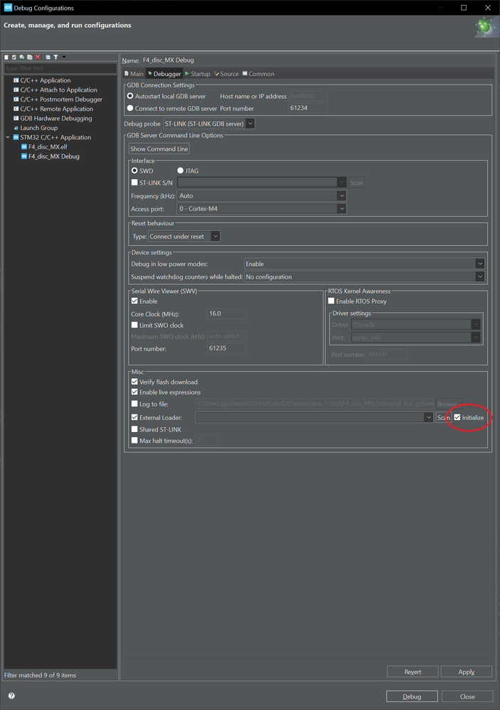

This could be because you need to initialize the external loader in your debug configuration inside STM32CubeIDE.
Do you know if this checkbox is checked?
It was unchecked, but checking it doesn't resolve the problem.
