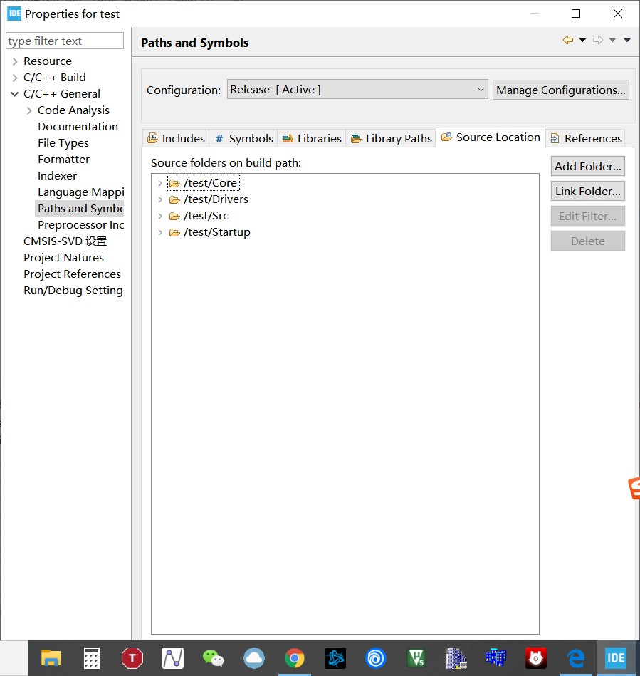

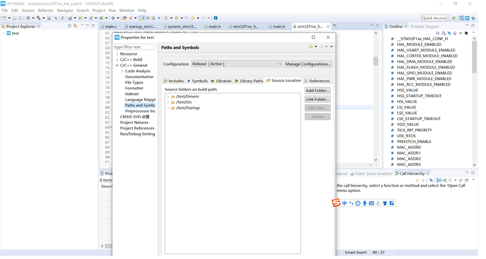

Hi, I met the same problem several days ago ,yesterday night I found the cause of this problem.
After “clean project�?, the directory of the project source file was missing, the file path under "/test/core " is missing.After manually adding the path "/test/core", the problem is solved. :face_with_tears_of_joy:I hope you can understand my poor english:face_with_tears_of_joy:
‎2019-06-11 12:01 AM
Hi @Zcj​
Glad you found the problem. Your english is great :)
