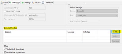

I am trying to flash the STM32H753I-EVAL-2 board with a .hex file generated from STM cube IDE version 1.14.0.
The code is build without error, but while loading it using the STMCube Programmer, I am getting the following errors:
Error: Failed to download Segment [1]
These are the options that I have selected while starting the programming :
External Loader selected: M29W128GL_STM32H743I_EVAL
KIndly help.

Did you select the proper external loader in the STM32CubeProgrammer?
You can follow this link, it may help you on your setup.
You have also to add properly the M29W128GL to your repository. In CubeIDE, click on the "Run" options and go to the "Debug Configurations" or "Run Configurations" Menu.
Check the external loader used in the" Debugger" tab and select the appropriate version.
Hope this helped you.
