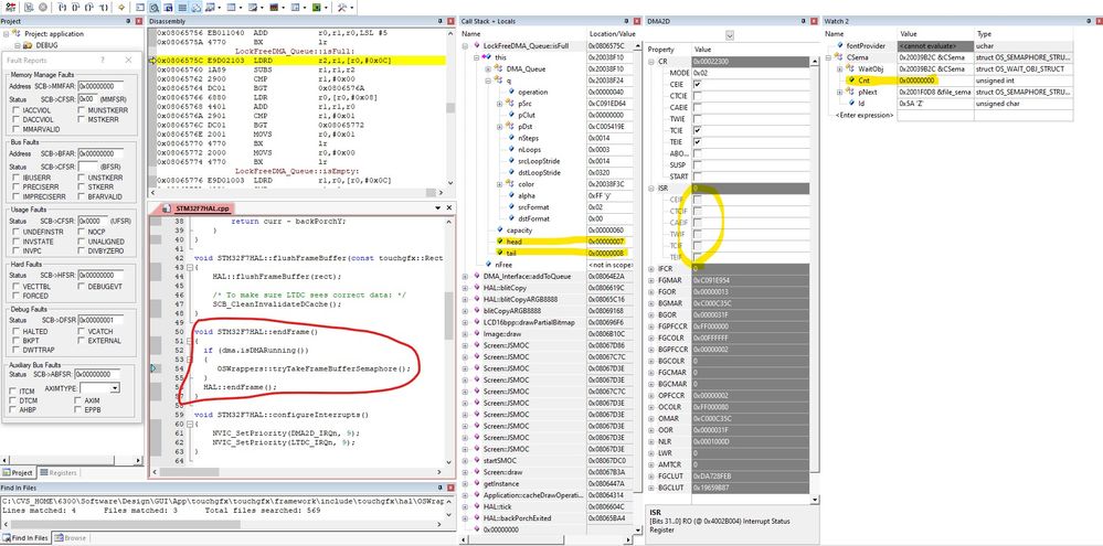

I’m using the licenced version of TouchGFX V4.9.2 in my project. The code runs on STM32F777 and segger emBOS OS.
Occasionally the TouchGFX task falls into an endless loop, waiting for DMA_Queue::isFull() to return FALSE while in DMA_Interface::addToQueue() function.
The only way to get out of this state is to reboot the hardware.
I tried to the below two steps to get out of lock-up state without rebooting the system, but didn’t succeed and TouchGFX code goes to lock-up state again.
1- disable DMA2D and LTDC interrupts and de-initialise them and then terminate the TochGFX task and de-initialise the LTCD
2- to initialise DMA2D and LTDC peripherals a create the GFX task
Any idea why this is happening and if there is a way to get out of this state without system reboot.

2019-10-30 11:54 PM
The suggested fix in the "TouchGFX Known Issues" didn't work on V4.9.3 then I upgraded to V4.12.3 still the same problem. TouchGFX core stays in addToQueue() function waiting for Queue to be available.
Attached is the screenshot of the Keil-IDE screen while in this state which contains:
- ST32 Core faults screen,
- Call stack screen
- DMA2D status screen
- Watch screen containing FrameBufferSemaphore (CSema) information

Strange, we fixed the issue for 4.12.0 specifically. I will try to verify! In the meantime, could you change the z-order of your textarea so that it is not the topmost element?
/Martin

2019-11-03 9:22 PM
Hi Martin,
While you are verifying the issue, is there a way to reset the TouchGFX core without rebooting the h/w?
I tried terminating the GUITask, resetting LDTC and DMA2D peripherals and interrupts, then recreating the task and enabling the interrupts. But it didn’t help as the “dma�? object’s scope is global so the core goes into the same hang state.
