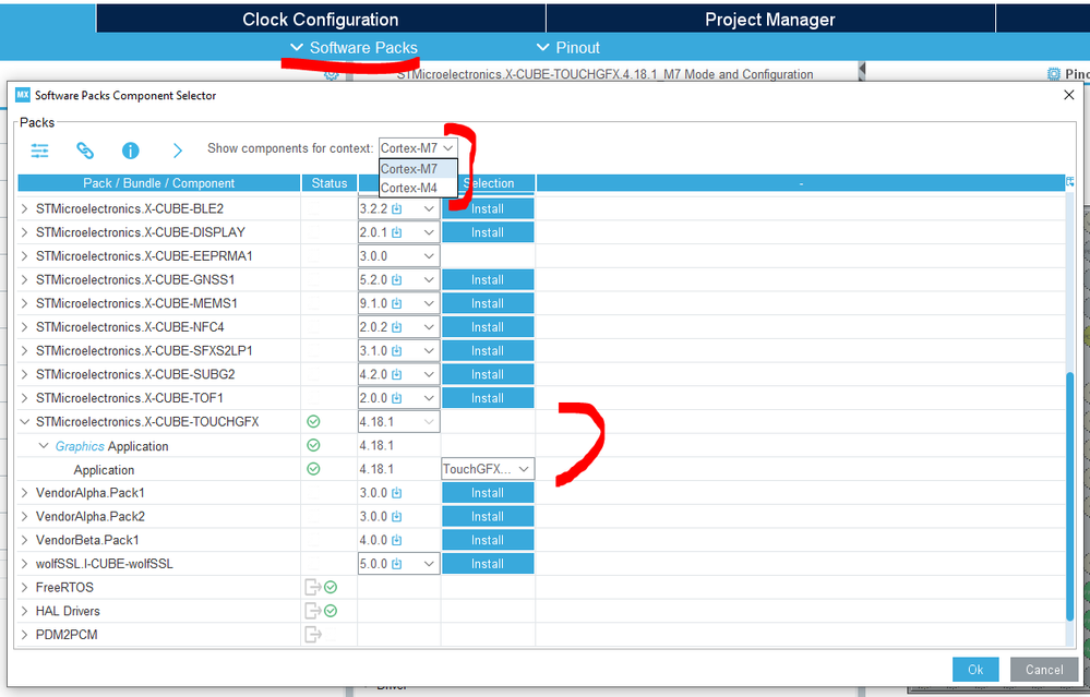

Dual core support: Using an stm32h747 how do i configure the board in order to generate the UI for the CM4 instead of the CM7 MCU?
When i generate code through the TouchGFX Designer it always generates the code to run mainly in the cm7 core, but i want ot use this core to do some heavy computation. Any help? Thanks

I suppose you used the TBS for the STM32H747 disco ? I suggest creating a dummy project with the same TBS on the side to compare the configuration and strip some code.
When you open the generated project in STM32CubeMX you can see in the Software Packs section that the TouchGFX Generator is set on the Cortex-M7. You need to untick that box and tick the one for the M4, then fill in the same settings as before.
Now that a TouchGFX folder is generated in the CM4 folder you should copy paste the files that were in the CM7/TouchGFX/target folder to the same folder in CM4/. You might have to dive in the code as well because there might be some links to files or folder to change. Same for the include paths for whatever IDE/toolchain you are using.

Romain DIELEMAN
Jan 21, 2022 9:19 AM UTC
Actually I got it wrong you cannot untick the M7 box in the TouchGFX Generator, you have to do that through the Select Component view in the Software Packs option like in the picture below.
/Romain

Thank you very much for the answer Romain.
I tried following your steps but even when I change the context and enable it on the M4, the folder touchgfx still gets created under CM7.
I'm using TouchGFX designer 1.18.1 and CubeMX 6.4.0, this is what I did step by step:
1) create a new protect from TouchGFX Designer, and generate the code
2)Open the .ioc generated with cubeMX and change the touchgfx execution context to the M4, generate code.
I've also tried creating a project from scratch using the CubeMx and changing the context of execution then generating code and still, the folder touchgfx does not get created inside CM4.
Do you see anything that I'm doing wrong?
