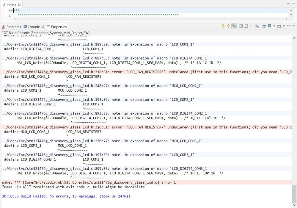

I have installed the example software for the recording machine on the STM32L476VG Disco MCU. The recording sofware has uploaded to the microcontroller. The mic input and the headphone outputs work fine.
TheLCD screen will not operate. I have installed the lcd.h and .c files for the MCU but I am getting 45 errors. Theses errors are unclear to me and I would like to know if aditional files are required or infromation an a suitable workaround for the problem. Can anyone help with this please?

you should check , reference manual or the description of the library for the internalization to be done , like starting the clock, enabling of control bit of the LCD , etc.
can you attach the screenshot of the errors that are occurring ???

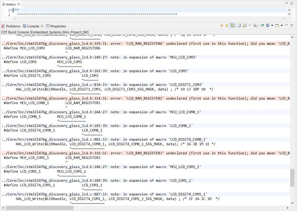

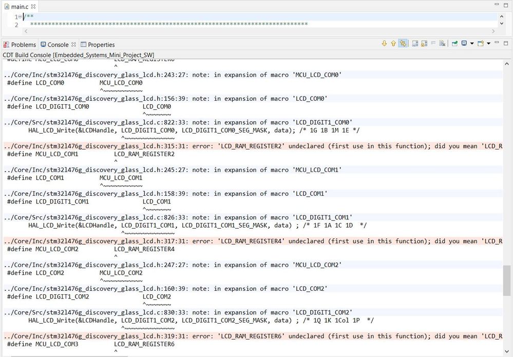

I have more snap shots but I didnt want to post too much. I have checked the manuals to see is drver file/s are missing but I cannt find anything. It looks like the LCD RAM registers are not accessible by the screen.A few HAL drivers are undeclared also.I have searched through the HAL driver manual and can't find a work around.
Try "greping" the files/directories you lifted the stuff from. The compiler's complaining it can't find components
For example LCD_RAM_REGISTER4
STM32Cube\Repository\STM32Cube_FW_L4_V1.14.0\Drivers\STM32L4xx_HAL_Driver\Inc\stm32l4xx_hal_lcd.h
Make sure that you've enabled the module at your project level configuration file
STM32Cube\Repository\STM32Cube_FW_L4_V1.14.0\Projects\32L476GDISCOVERY\Examples\BSP\Inc\stm32l4xx_hal_conf.h
#define HAL_LCD_MODULE_ENABLED // << UNCOMMENT THIS LINE TO FACILITATE PULLING THE LCD
#ifdef HAL_LCD_MODULE_ENABLED
 #include "stm32l4xx_hal_lcd.h"
#endif /* HAL_LCD_MODULE_ENABLED */
This might have some cascading dependencies on other modules, and you'll need to check those or against other buildable projects using the same components you want to use. The use of diff/merge type tools can help identify nuanced differences.
What do mean "installed", trick here is to add the .C files to the project, and point at the include files via the "Include Paths", and to ensure that the stm32xyz_hal_conf.h enables the inclusion
