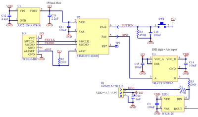

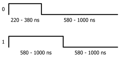

I'm trying to talk to a string of WS2812C LEDs with an STM32C011J4M6. The timing requirements are:
Here's the schematic. I populated R3 and removed R1:
I'm hoping for the simplest hardware implementation, so I'm using the HSI 48MHz clock. This means that each clock cycle is 20.8ns, which means that, for a 0, the pin can only be high for at most 18 clock cycles. With that in mind, I tried to write the most efficient driver that also takes the same time for each bit.

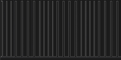

My problem is that, when I try to output a string of 1s, the timings vary despite the code being the same for each bit:
I get 4 short pulses (840ns, good) followed by 4 longer pulses (1670ns, too long). Somehow, ~45 extra clock cycles are embedded in the long pulses, which doesn't make any sense since the code is the same for each bit.
Is the microcontroller doing background tasks or something? Why is the timing different in such a predictable way?

For anyone who has the same question in the future, I ended up implementing a PWM + DMA solution by following this video and modifying the timing parameters to fit my use case: https://www.youtube.com/watch?v=-3VKkTSAytM

Use UART or SPI to generate the WS2812 data stream in hardware. Also, no need for a level translator - configure the pin as open drain and use external pullup resistor of 1k5..4k7 to +5V.
HAL uses SysTick interrupt, so any attempt to use software timing will fail at some point (every millisecond to be precise).

For this, Google really is your friend: Search for "neopixel stm32" or similar.
From what I've seen, I think people have the most success with SPI (ideally with DMA).
Or PWM with DMA - that works fine.
