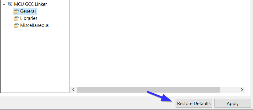

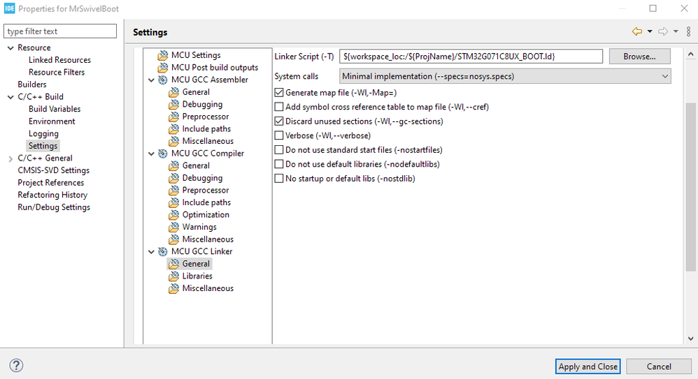

‎2021-03-18 10:24 PM
Hard to find. Just incase you still struggling and for those in are new:
In this example, Make sure Linker has STM32....._FLASH.ld
‎2021-03-18 10:25 PM
‎2022-02-17 1:23 PM
I solved by applying restoring defaults then apply and close
